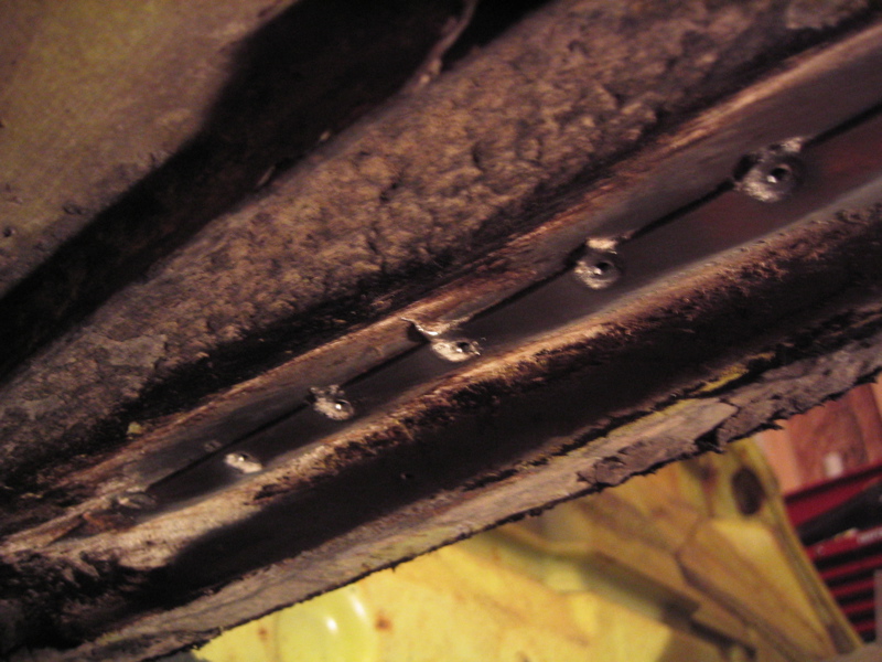

#2 - Drill a small hole in the center of the spots. (I went to a smaller bit after these pics.) Some would say it's not good to go all the way through, but if the long is solid, this shouldn't be an issue. Besides, were going to re-weld something over it and seam-seal the whole thing, so we should be in good shape.

CptTripps   #2 - Drill a small hole in the center of the spots...   Jan 29 2005, 11:13 AM
