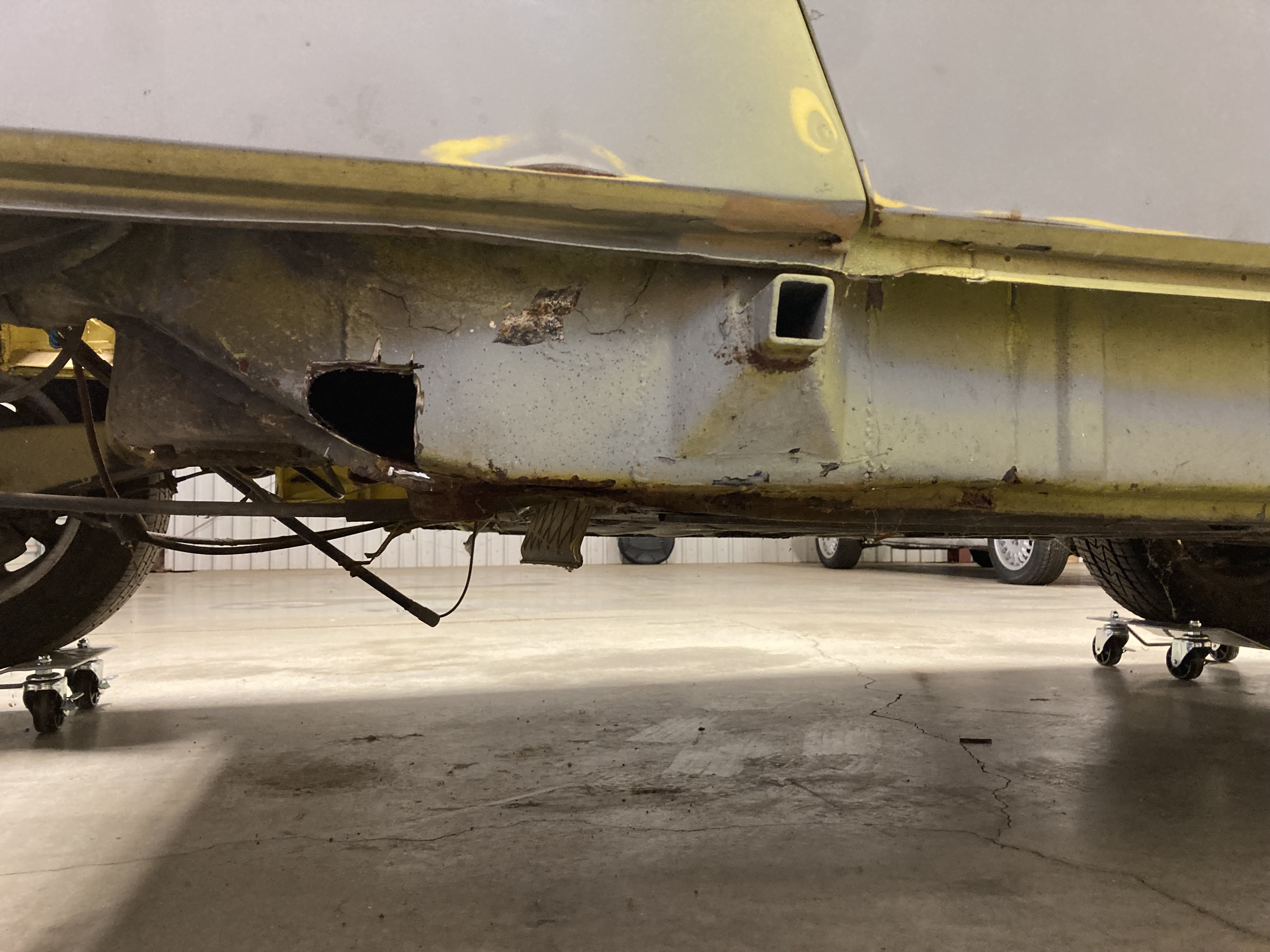

I’ve thought about going the route of just getting the engine on the stand in the car to evaluate and drive the car for the year, but there is a rust area that I have attached that is a little concerning. I cut it out and it’s not as bad as I thought, but I’d still replace the long. I had thought about just patching it for this year then doing the body work this winter, but need to reassess.
