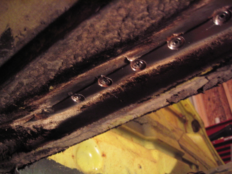

CptTripps   Ok, I think I have a system here for removing the ...   Jan 29 2005, 11:09 AM
CptTripps   #1 - Remove all the undercoating. I used a 6" wire...   Jan 29 2005, 11:11 AM
CptTripps   #2 - Drill a small hole in the center of the spots...   Jan 29 2005, 11:13 AM
CptTripps   #3 - Use the spot-weld remover. Put the center pin...   Jan 29 2005, 11:15 AM
CptTripps   #4 - Seperate the pan from the chassis. Let's ...   Jan 29 2005, 11:17 AM
CptTripps   #5 - Check it out. Your pan should drop easily. Yo...   Jan 29 2005, 11:19 AM
CptTripps   Ok...Back to the garage to get it all out of there...   Jan 29 2005, 11:22 AM
