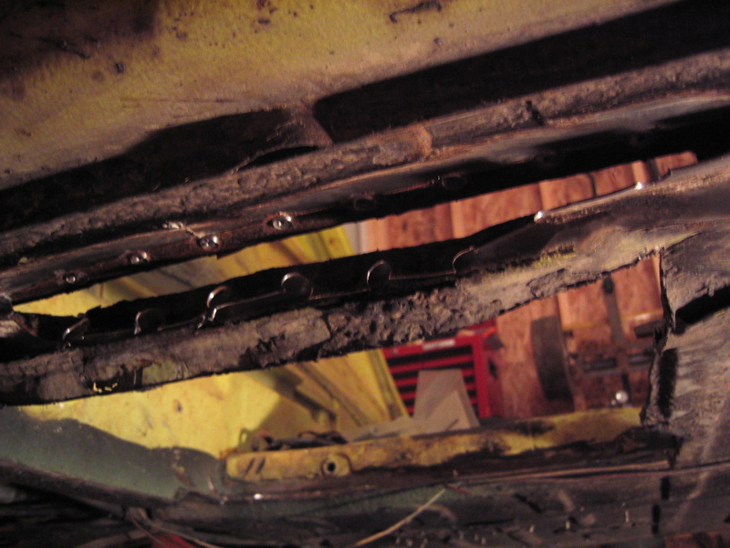

CptTripps   Ok, I think I have a system here for removing the ...   Jan 29 2005, 11:09 AM
CptTripps   #1 - Remove all the undercoating. I used a 6" wire...   Jan 29 2005, 11:11 AM
CptTripps   #2 - Drill a small hole in the center of the spots...   Jan 29 2005, 11:13 AM
CptTripps   #3 - Use the spot-weld remover. Put the center pin...   Jan 29 2005, 11:15 AM
CptTripps   #4 - Seperate the pan from the chassis. Let's ...   Jan 29 2005, 11:17 AM
CptTripps   #5 - Check it out. Your pan should drop easily. Yo...   Jan 29 2005, 11:19 AM

CptTripps   File this under 'while I'm in here' or...   Feb 5 2005, 12:01 AM
CptTripps   Let's cut it out and see what we have.... Not...   Feb 5 2005, 12:03 AM
CptTripps   Inside the long is amazingly....still shinney meta...   Feb 5 2005, 12:05 AM
CptTripps   I cut everything back to 'good metal' and ...   Feb 5 2005, 12:08 AM
