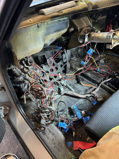

With help from many of you and the expert fabrication of Chris Foley from Tangerine Racing, the conversion of my 1971-6 GT clone interior is well underway. Next up is the wiring cut over, which won't be easy but I'll post later on that rat nest of issues.
Chris built the roll bar, and harness mounts, fabricated the fuel gauge mount and battery cut off mount and welded in the column (thanks to Mark Epstien for bracket and Tom Bulter for help)

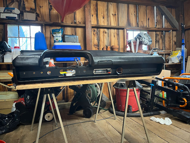

I've nearly got the dash together and it's ready for install.
After fitting the 911 ignition and lock (it works), I pulled the dash to get better access to the wiring. It's nearly impossible to get the light switch down without removing the dash.
When all the dash wiring was free I nearly cried. What have I got myself into? Good to pause, drink a beer or two and consider what comes next. I do have a plan thanks to the excellent wiring assistance from Ken Salvail and Tom Butler:
http://www.914world.com/bbs2/index.php?showtopic=369800
I'm not sure if I have the sequence right, but I decided to finish the dash refresh first and then reinstall the dash so I could move through each switch and have a finished dash before lighting the fuse, so to speak. Hopefully no sparks. Onward!
