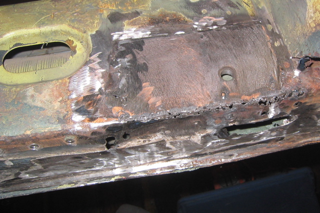

While I was grinding away, I stayed on one part a little long, and ended up burning a hole through the long. Typical!
There was a bit of rust inside, but nothing that had broken through yet. Just a matter of time, so I cut out the 6X3 patch, and welded it up 'while I was in there'. (Famous last words...)

CptTripps   While I was grinding away, I stayed on one part a ...   Jan 29 2005, 02:22 PM
