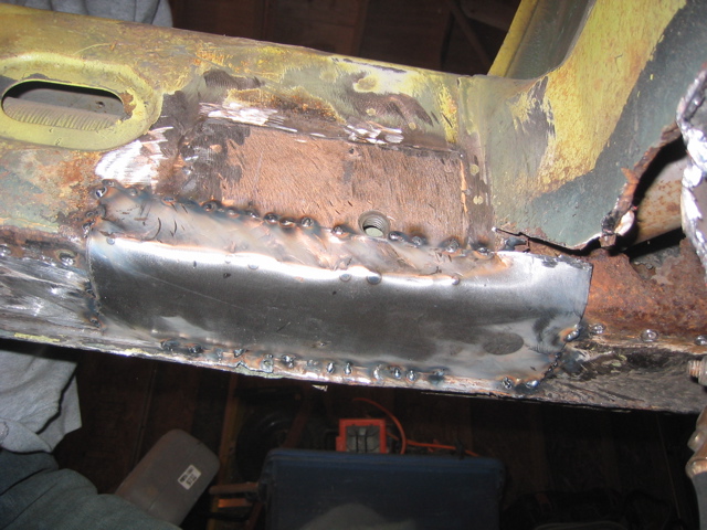

Here's the patch I made...

CptTripps   While I was grinding away, I stayed on one part a ...   Jan 29 2005, 02:22 PM
CptTripps   Here's the patch I made...   Jan 29 2005, 02:23 PM
CptTripps   I did a bunch of plug welds, but the battery died ...   Jan 29 2005, 02:25 PM
