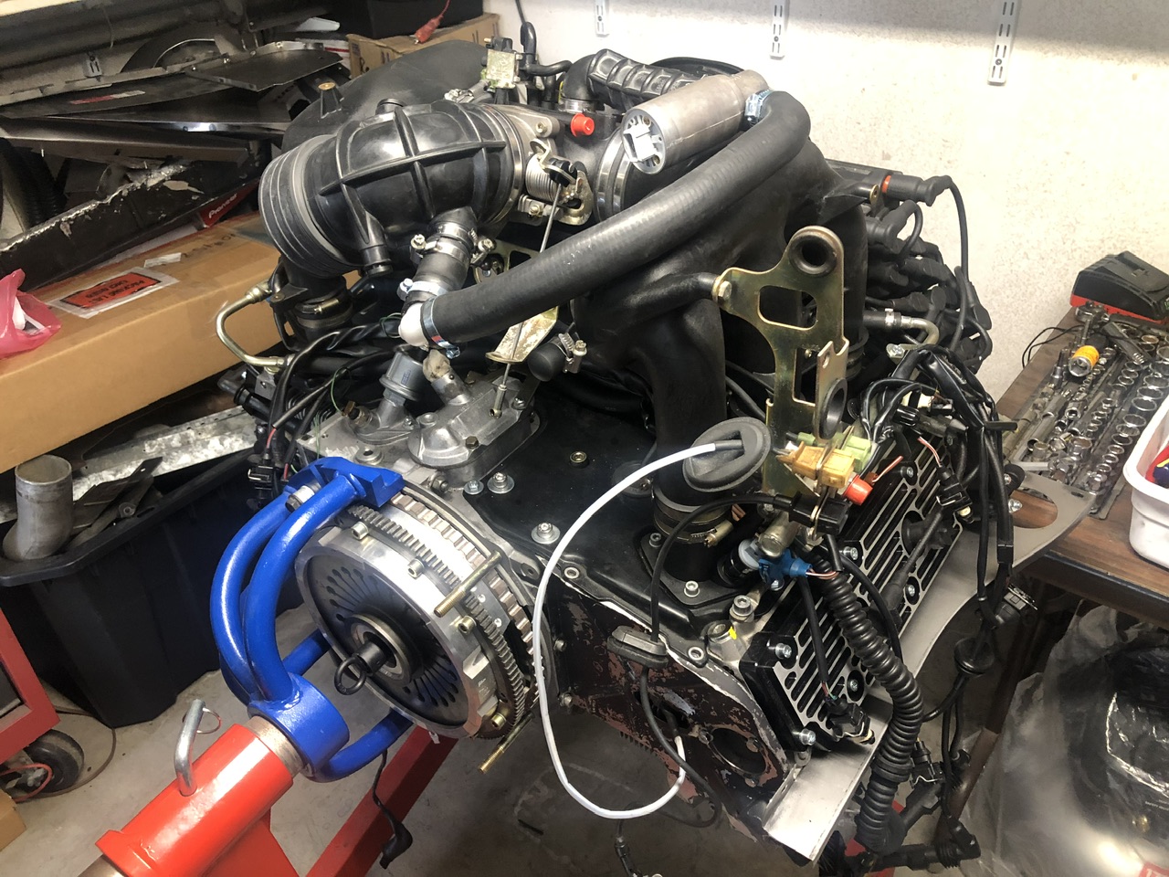

Plumbed the idle control valve into the new PMS 3.2 elbow. Blocked off extra vacuum lines. Added the distributor breather to Mickey Mouse heat exchanger ears. Also added another fitting for the charcoal canister. Next steps is the tin. This thing is a pain compared to installing a 3.2, but I know it will be worth it in the end.

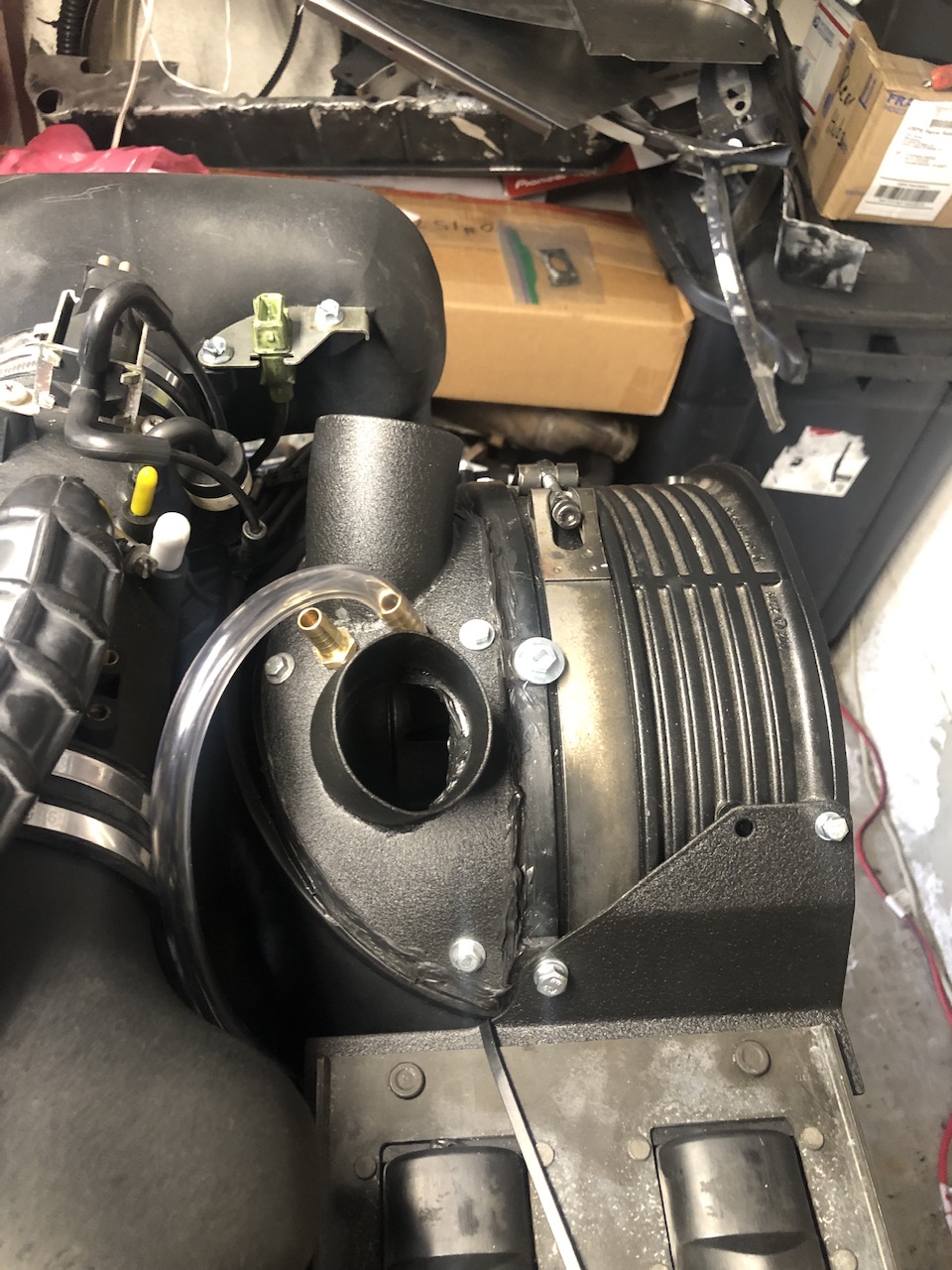

Steve   @sirandy [b]@[url=http://www.914world.com/bbs2/...   May 5 2024, 07:48 AM
SirAndy   @[url=http://www.914world.com/bbs2/index.php?show...   May 5 2024, 10:28 AM
Cairo94507   :popcorn: :beer2:   May 5 2024, 08:49 AM
SirAndy   You can sort of see where it all ended up here: h...   May 5 2024, 10:35 AM
SirAndy   And this shows you where my air filter ends up: h...   May 5 2024, 10:37 AM
SirAndy   I think that short 90 degree bend piece between th...   May 5 2024, 10:40 AM

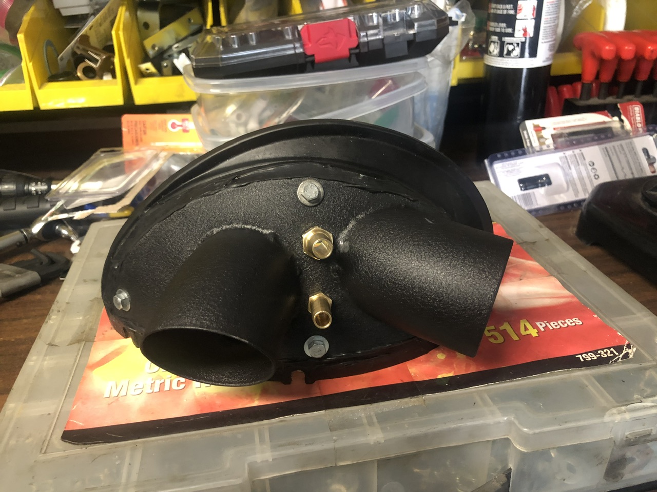

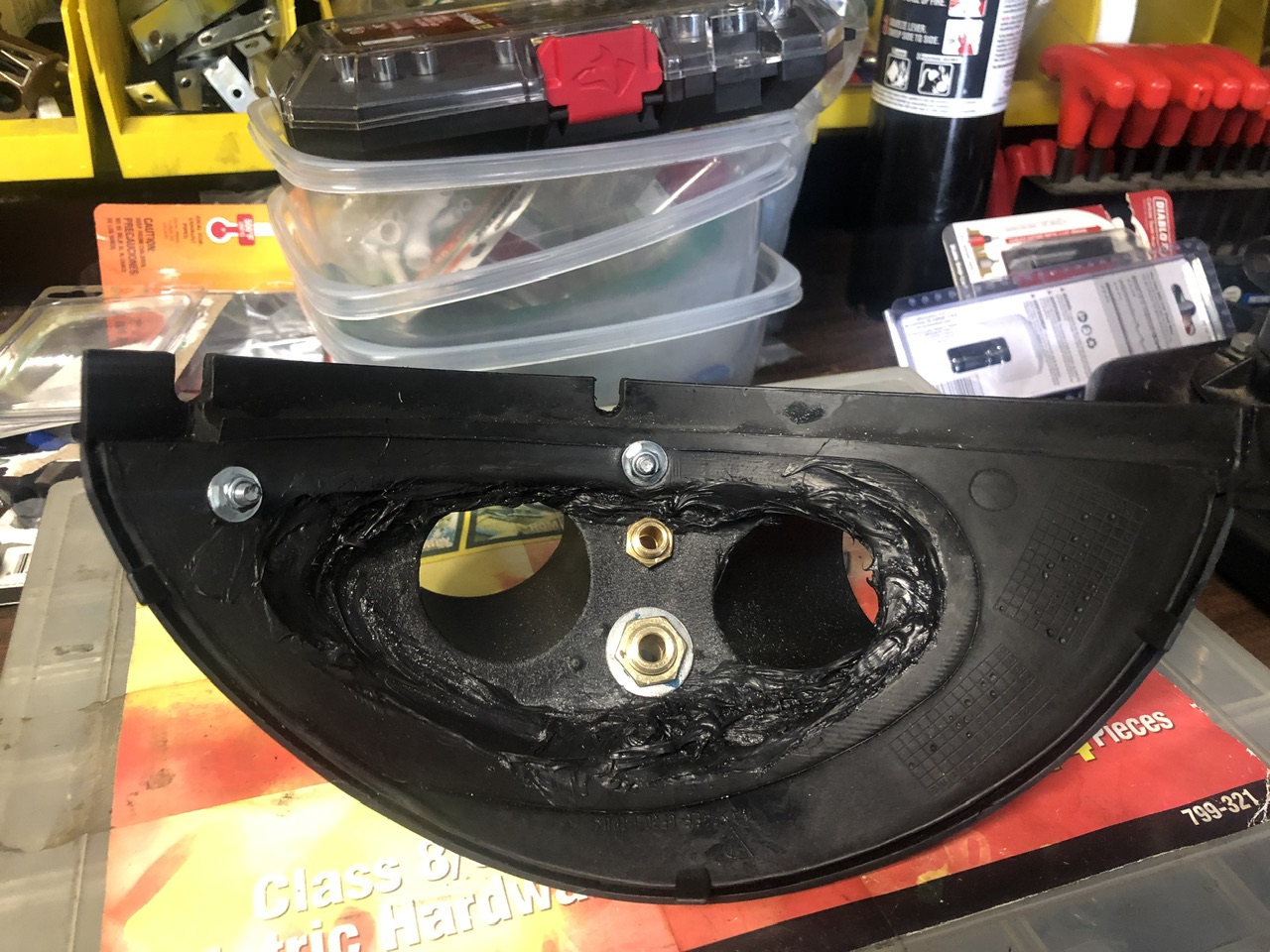

Steve   While I am waiting for my tin to come back from po...   Jun 3 2024, 01:45 PM
East coaster   I remember doing this on my 3.6, it’s really not...   Jun 3 2024, 05:02 PM
