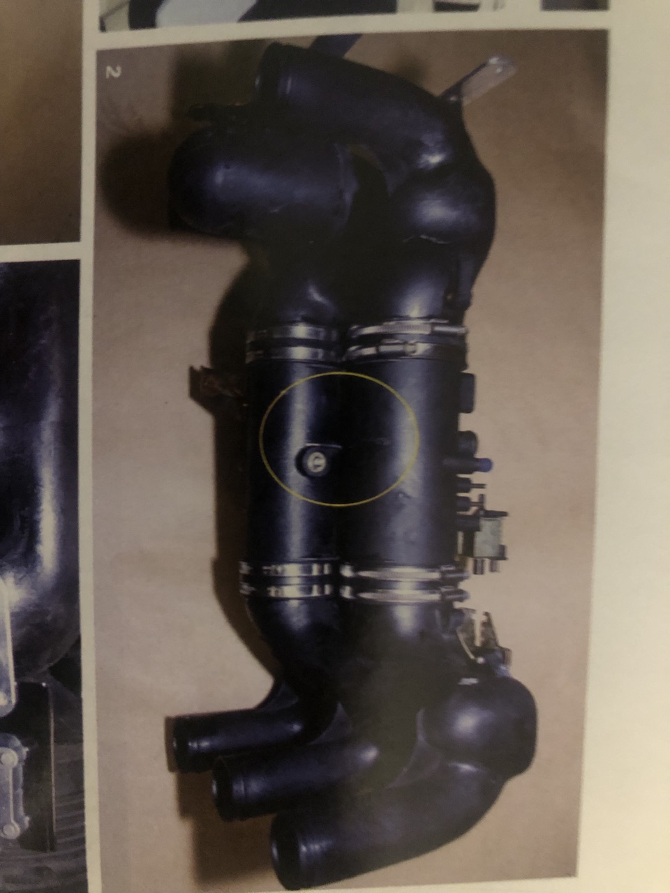

@sirandy @clayperrine did you have to cut the rib on the intake manifold to point the throttle body straight back like prs9146 to clear the engine lid?
post May 5 2024, 10:28 AM
Resident German
Posts: 42,558
Joined: 21-January 03
From: Oakland, Kalifornia
Member No.: 179
QUOTE(Steve @ May 5 2024, 06:48 AM) *
@Steve
Yes, i did. I removed the bridge so you can rotate the two pieces independently.
