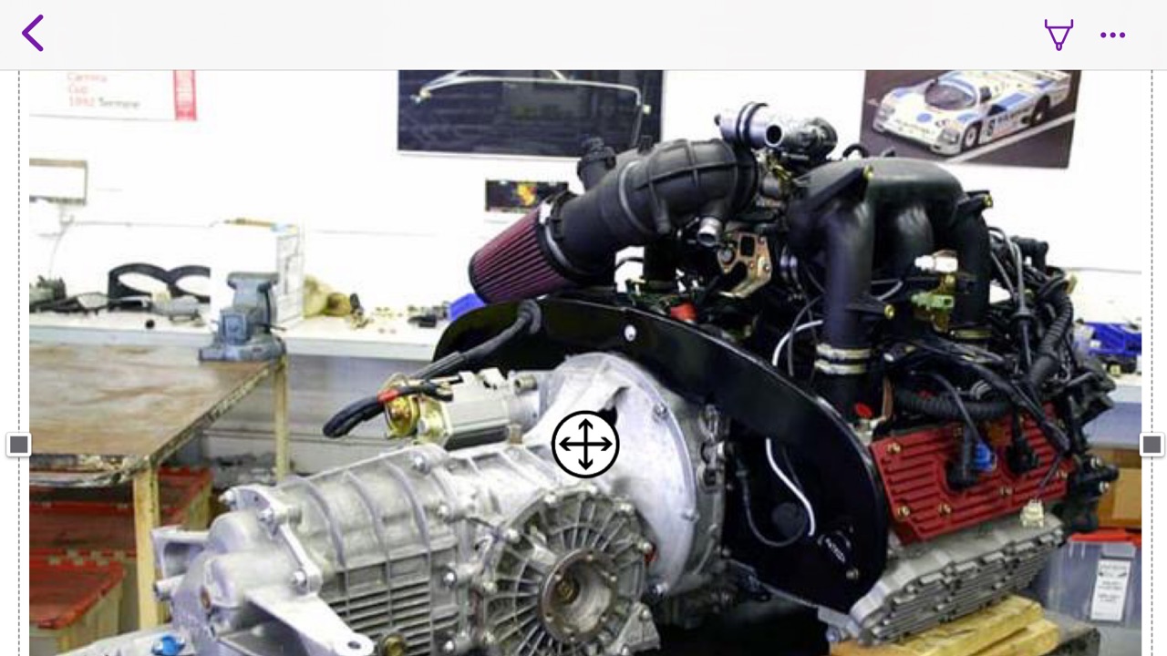

@sirandy looks like you added another 45 degree elbow to the 3.2 elbow.
This allowed you to point the 3.2 elbow more down, so you could run the idle control valve hose on top.
I found this PMS picture with the 3.2 elbow flipped, so the idle control valve hose is underneath. I think this picture is the big Laguna motor.

QUOTE(Steve @ May 5 2024, 02:38 PM) *
@Steve
Ah yes, you are correct.
The second elbow is a Mustang part, must have been from a pre 2006-ish model since that's when i did the conversion.

QUOTE(SirAndy @ May 5 2024, 04:11 PM) *
@Steve
(IMG:style_emoticons/default/beerchug.gif) Awesome! Thanks!! This is the easy part. I will figure this out with the engine in the car. I will most likely run the hose underneath.
