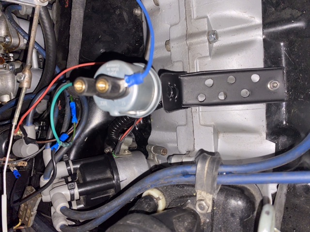

Heres the part I used and I fabbed up a mount for it
Not sure I like it front and center but it will do for now Attached Image Attached Image

IVGUY   Heres the part I used and I fabbed up a mount for ...   May 29 2024, 10:21 PM
BillJ   Hi! That particular 914 now lives with new ow...   May 30 2024, 10:31 AM
IVGUY   Yes i have a small rubber washer under the bracket...   May 30 2024, 06:45 PM
