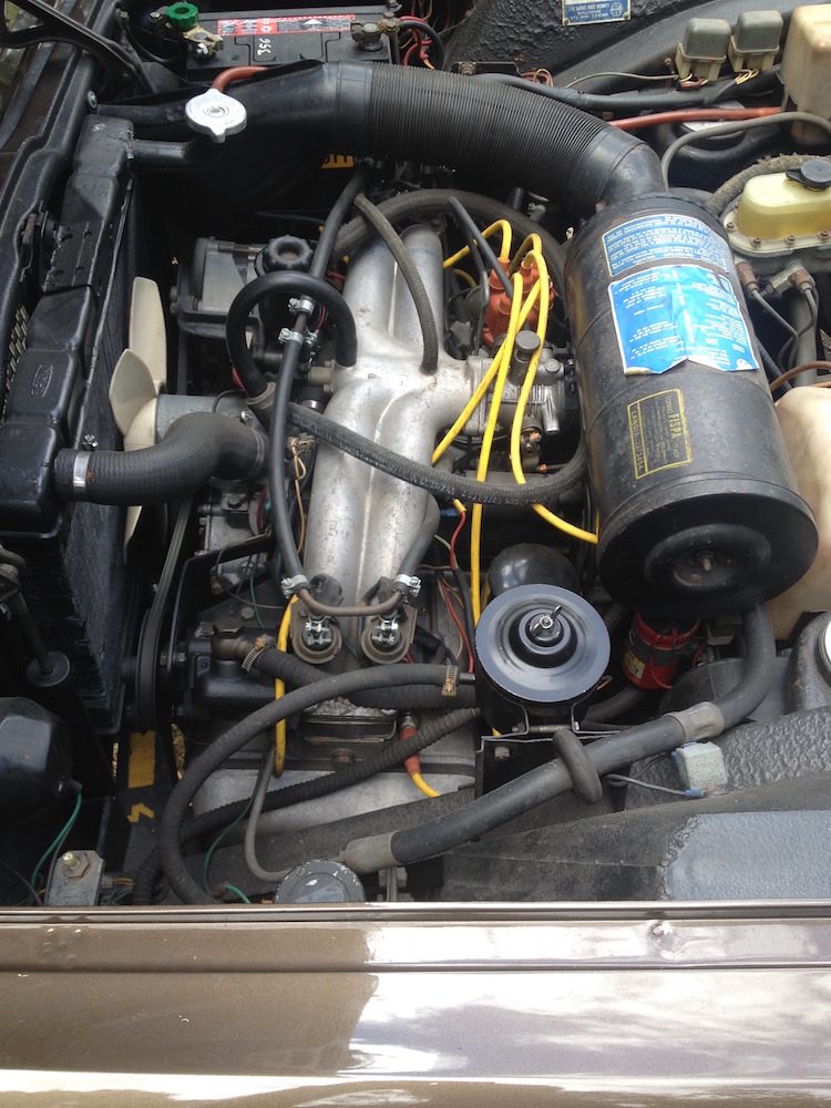

here you go for some "world wide" D jet.
sorry to side track off L jet.
a mate of mine's lancia saloon.
neat little car.
still running its original D jet.
think its a 72 but don't quote me on that.
(has a 5 speed box with identical dog leg shift pattern to a 914).
there were quite a few of these in aus.
i believe they were preferred to the twin carbs. did not go out of tune.
but kind of intimidating to your average fix it again tony mechanics.
you had to find a rational german to look after it because the italians got hysterical.

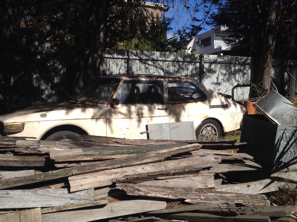

he had a pile of swedish rust under a tree a few feet away from it.
under the faded paint and oxidation also lurked an intact D jet system.
74 SAAB.
i scored a fuel pump off it as a spare for my 914 before it went to the graveyard in the sky.
most of the SAABs that came here in early to mid 70s ran D jet standard.
and there were lots of these SAABS.
they sold like hot cakes. great cars actually.
