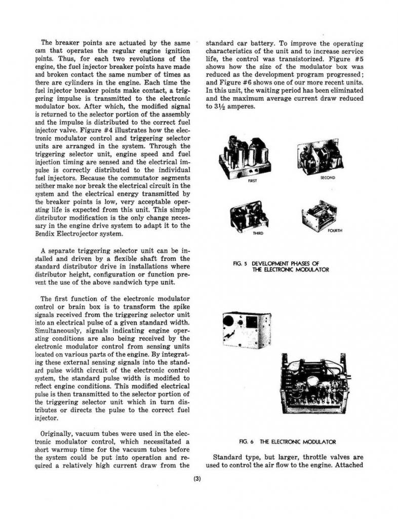

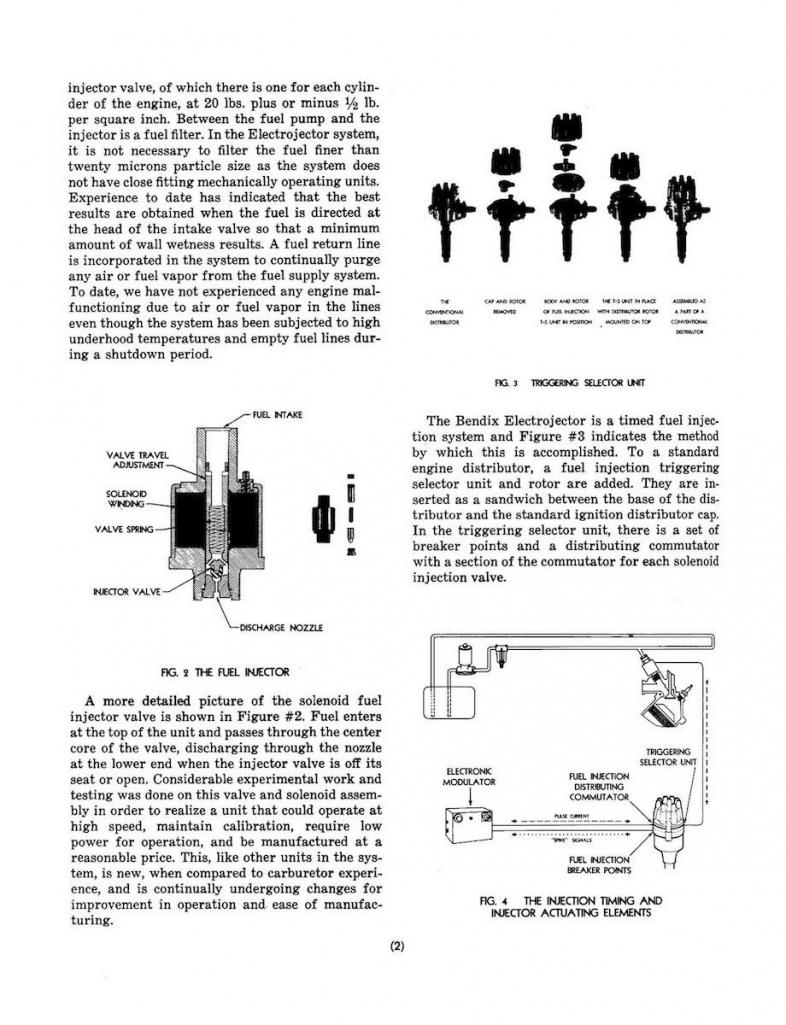

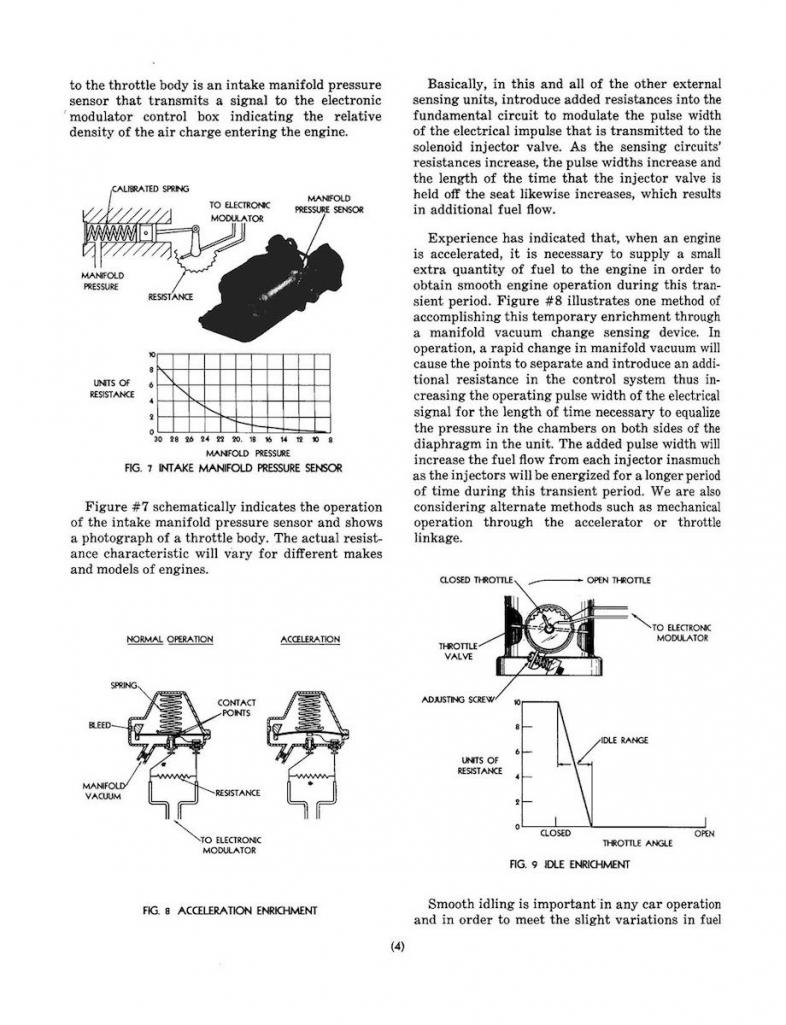

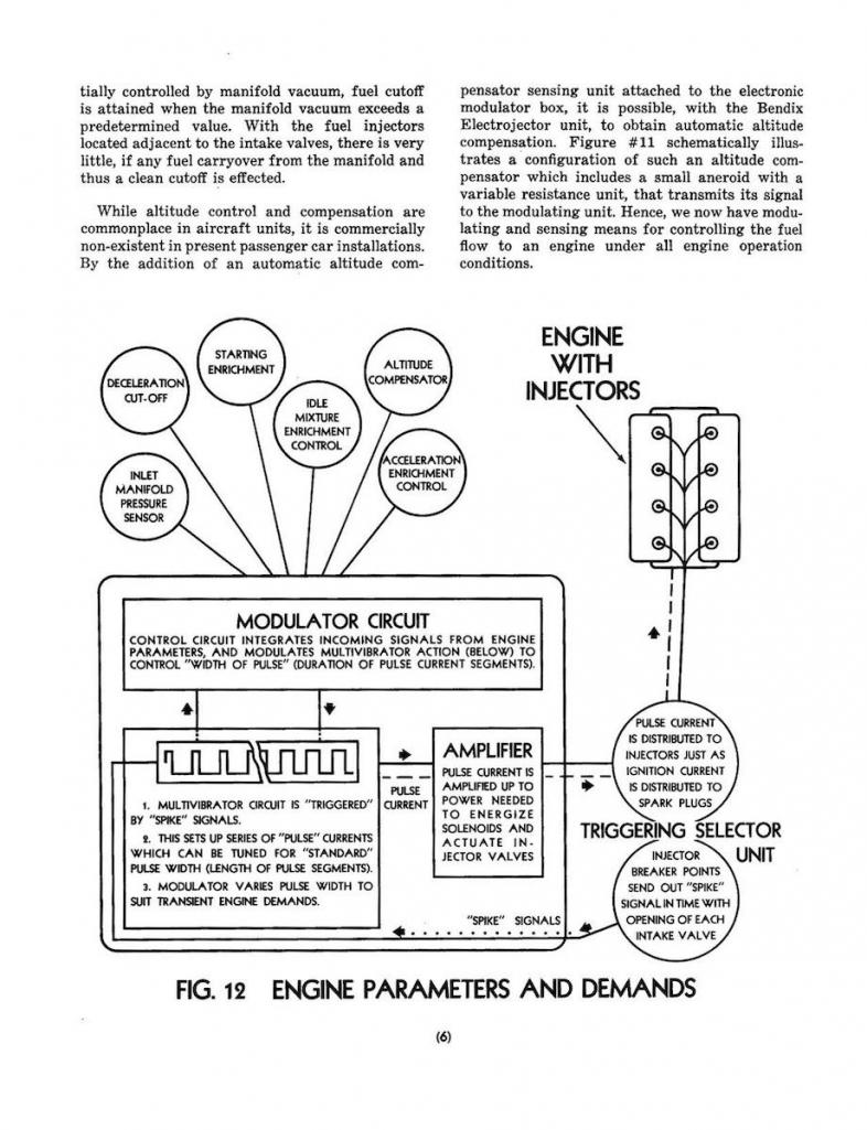

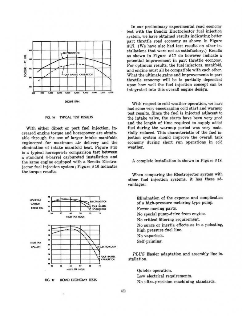

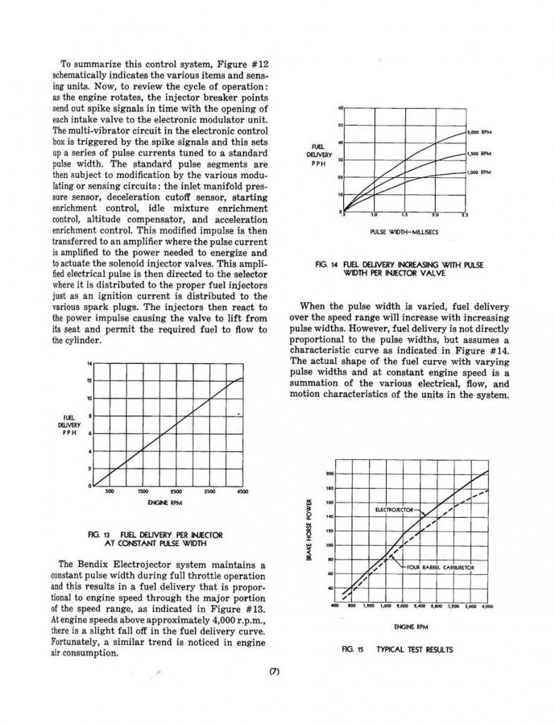

@technicalninja
and anyone else vaguely interested.
the original SAE paper written by the development engineers at Bendix behind the system. paper dates from the late 1950s.
for those of you with D jet you will recognise all the components.
including the operation of the lower half of the ignition distributor.
some of you probably already have this paper.
i would imagine mr b. ( @JeffBowlsby )has it stashed away in his files.
i found it in an obscure section of junk i had filed away on origins of L jet.
(IMG:style_emoticons/default/biggrin.gif) (IMG:style_emoticons/default/beerchug.gif)
never been able to find any contemporary papers or such on L jet dating from the time of its development.
i guess it was all ho hum by that point in time and no big deal?
all part of the general horror of emission controls negativity.
in the main bendix got done in by external electronic interference of the electronic control unit. vulnerable to electric fields etc. at least understand that appeared to be what caused huge problems and was not detected during factory testing. or as some stories go bendix did not get done in but chrysler perhaps failed to execute to the necessary high standards for components. (bean counters at work?)
bosch cracked it. made a better shielded control unit. took them a lot of hard work though. i believe bendix made money out of every bosch unit sold. good way to make coin. like printing money? (IMG:style_emoticons/default/biggrin.gif)
