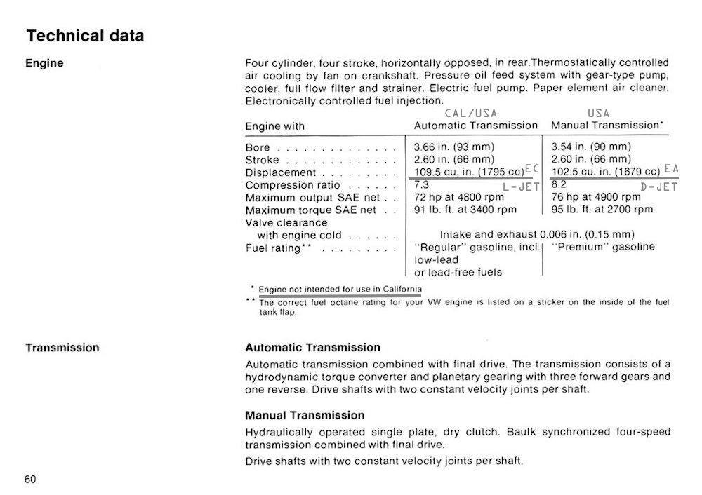

you can see the quandry for the last of the 412s in 1974.
the high compression 1.7 soldiers on with a 8.2:1 and will only take 98 RON.
could not be sold in california on fuel requirements alone.
and technically ought not to have been sold in rest of USA.
i suspect VW pulled the same trick as they did with the 76 914.
they probably only made it up until the end of calendar year 1973 which meant 1973 standards could be applied. technically it was likely a 73 for certification purposes but sold in showrooms as a 74 while stocks lasted.
here are the specs for the 74 412 from owners manual.
i suspect that no matter what D jet hit the wall emissions wise by 75.
the 76s never met 76 emissions standards and certification.
were sold as 76 model year but under the certification regime were classed as 75s if manufacture ceased by end of calendar year 1975 - which they did.
