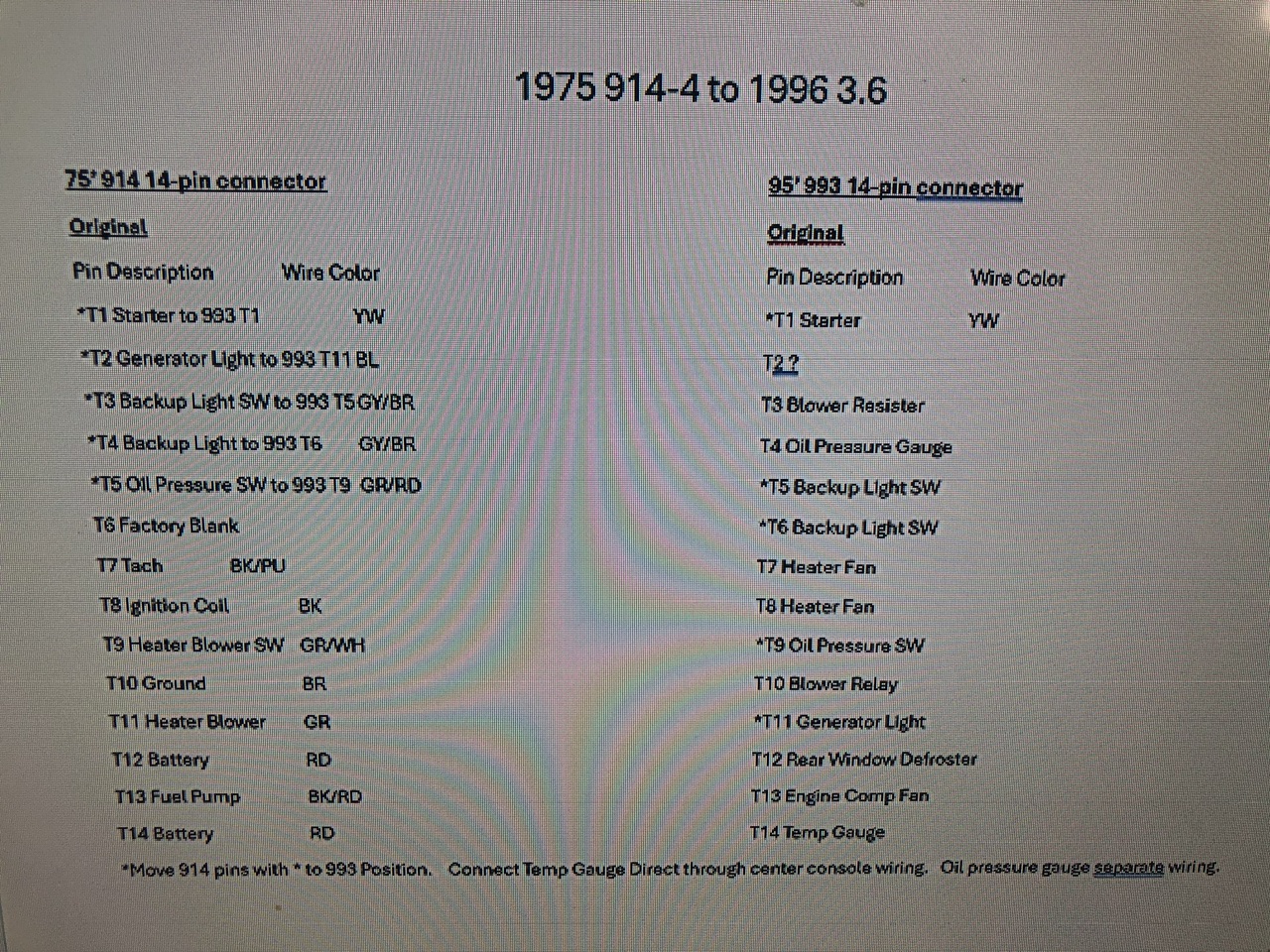

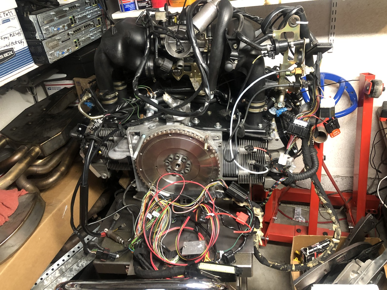

While I am waiting for my tin to come back from powder coating, I thought I would tackle the wiring. Pretty straight forward. When I installed my first six back in 86, I dumped the relay board, bought a 14 pin connector and made my own adapter. I moved the pins around in the 14 pin connector to match up with the 3.2. The 3.6 is a little different, but no big deal to move the pins around again. Hear is a picture of the mess and my adapter notes. Tons of left over sensors and power plugs.
