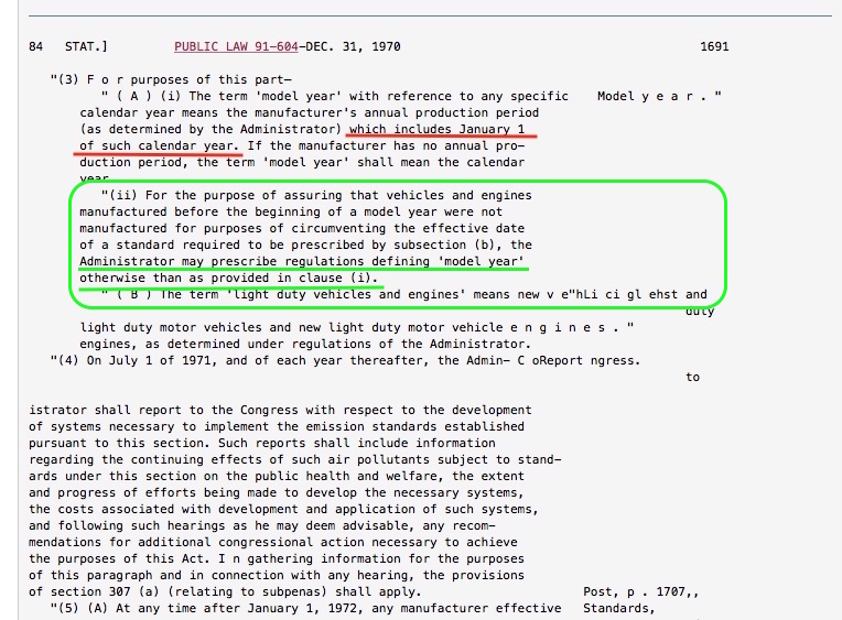

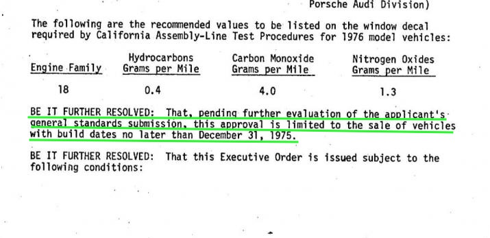

here is the link to the topic where the CARB specification/certification is posted for the 75 and 76 2.0.
http://www.914world.com/bbs2/index.php?sho...64241&st=20
and here is the info on how model year cars were defined in terms of which calendar year standards were applied. don't get a headache reading. classic legal gobble de gook you have to read 5 times and think did i just understand that or....... (IMG:style_emoticons/default/confused24.gif)
and this is the very strict limitation put on 76 914 CARB certification.
the certificates for all the other MY 914s do not have this limitation.
sh$t i stumbled across researching entirely unrelated matter of 1.8 L jets.
because 74 L jets have weird vague emissions stickers that we recently discovered the USEPA and CARB must have pulled them up on so they had to correct the emissions stickers for the last month of 74 49 state 1.8s.
its whacky stuff. classic regulation bureaucracy stuff. they are a slow chasing you but they never give up (has been my experience in life (IMG:style_emoticons/default/biggrin.gif) ) took em all year to catch up with VW on the 74 1.8 914 but they caught em right at the end and made them fix it.
since stumbling on this i have worked out at least three cars that sneaked through on this techicality.

the point about a 76 914 is that it isn't the CARB waving around some abstract emissions limits in the air, they are pulling out the certification documents. and those are identical to the 75 model because though it is a 76 it qualified for 75 level emissions. it is not build in a time period that includes Jan 01 of its model year. hilarious.
it still obviously gets caught out for smogging exclusion cut off date because CARB are probably setting that trigger as a model year rather than a calendar year.
its one of those things that you guys invented for yourselfs.
the weird concept of a model year which is aug of the year before to july of year named.
we didn't have this down here. model years conformed to calendar years.
and i know why. our summer break was in january. natural time to shut down factory to gear up for new model changes.
