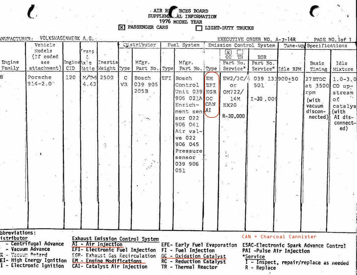

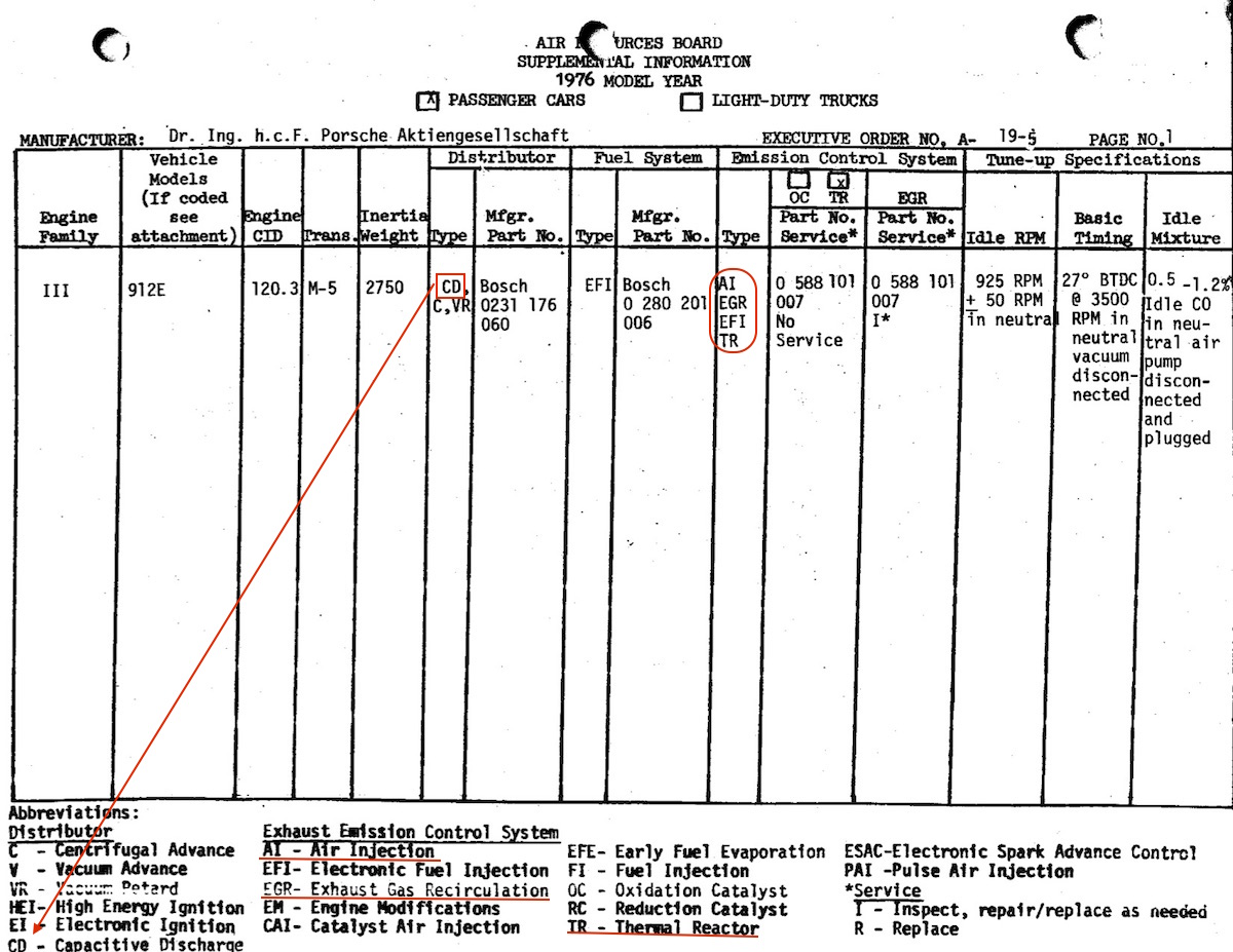

here is the emission specs on the two different 76 models for the same niche.
as recorded on CARB executive orders.
the 76 (75+) 914 2.0 D jet. (75 2.0 is identical in all respects - same sheet with 1975 on it).
the true 76 MY 912E with L jet.
pretty much the same - egr, airpump, but 912E runs thermal reactor exhausts instead of cat. (Although i have no idea what that all encompassing term - EM = engine modifications means for 914 2.0? (IMG:style_emoticons/default/biggrin.gif) ) suspect reason for reactprs on 912 is porsche still had not developed an exhaust system with a cat that would fit in to limited space available with rear engine layout. 911s also had reactors. same problem?
the 912E version of the 2.0 L also got capacitive discharge ignition. don't believe the humble 914 L jets have got that. dunno about 2.0 L 914s
and as far as i can figure out the hp rating goes like this.
a 2.0L 76 914 had 87 bhp or 88PS (euro standard hp). 88 usually quoted.
a 912E had 86 bhp so maybe 87PS.
lost about 1hp over the 914.
suspect with D jet if they could have made it work even more hp loss.
unlike the 914s porsche did do the test work and development on the L jet 912E.
they ran the test car out of the factory from about mid 75 on. had about 6 months before it went into production to make sure it worked ok.
if they could have i am sure they would have kept going with D jet, for the sake of 6 months of cars. but something stopped them.
as a little side note you can see from the certificates that neither the EGR or the CAT could be warrantied for the full 50,000 miles required. hence the I for inspection condition and i guess the mileage counter that had to go in to the 914s of that time with the CATS. already knew they wouldn't make it through full warranty period........
and i am guessing but i could be wrong you would have got that replacement for free?
as part of having to warranty it for 50,000 miles. i imagine anyone who knows for sure and managed to get that service is probably dead these days. (IMG:style_emoticons/default/sad.gif)
