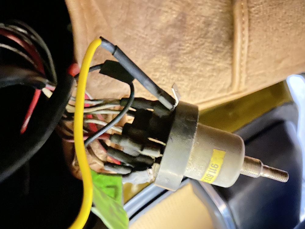

Can you post a photo of your switch, and perhaps the contact positions?

QUOTE(davep @ Jun 12 2024, 02:19 PM) *
photo impossible file too long

mgarrison
post Jun 12 2024, 01:33 PM
Posts: 398
Joined: 14-February 20
From: Chandler, AZ
Member No.: 23,922
[quote name='LUX-PIERRE' date='Jun 12 2024, 09:37 AM' post='3150558']
photo impossible file too long....................
(IMG:style_emoticons/default/headbang.gif)
[/quote]
[/quote]
Looks like a 911 switch/part number... (IMG:style_emoticons/default/popcorn[1].gif)

LUX-PIERRE   hello sir, I am from Belgium and I have a 914/1800...   Jun 12 2024, 03:51 AM
davep   Can you post a photo of your switch, and perhaps t...   Jun 12 2024, 07:13 AM
LUX-PIERRE   Ok   Jun 12 2024, 10:01 AM
davep   Can you post a photo of your switch, and perhaps t...   Jun 12 2024, 07:19 AM
LUX-PIERRE   Can you post a photo of your switch, and perhaps ...   Jun 12 2024, 10:32 AM
LUX-PIERRE   photo impossible file too long.......................   Jun 12 2024, 10:37 AM
LUX-PIERRE   photo impossible file too long......................   Jun 12 2024, 11:46 AM
mgarrison   photo impossible file too long......................   Jun 12 2024, 01:33 PM
LUX-PIERRE   I bought the car like that!! what can I do...   Jun 12 2024, 12:40 PM
JeffBowlsby   I bought the car like that!! what can I d...   Jun 12 2024, 02:23 PM
LUX-PIERRE   thanks for everything guys!! but I succeed...   Jun 13 2024, 03:44 AM
mgarrison   Maybe this helps... :confused:   Jun 12 2024, 10:04 AM
JeffBowlsby   That switch is not correct for your 914 1.8L. The...   Jun 12 2024, 12:07 PM
