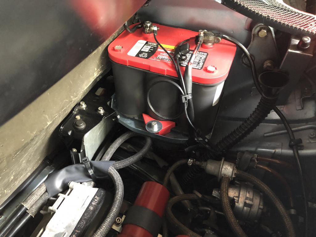

This one was purchased in 2008. I cooked the first one from 2007 when I shorted the terminals. Optima replaced it for free.
