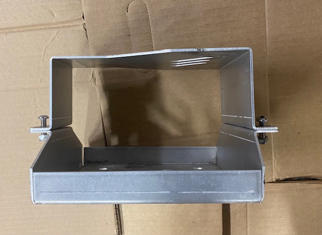

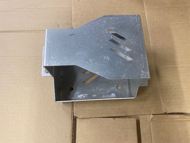

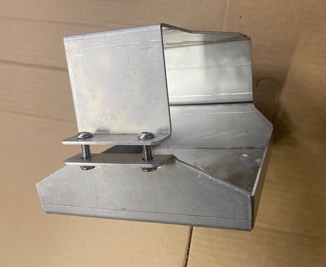

Ordered the posts. What frame did you buy/use?
@mb911
IIRC I got it on eBay. Pictures below. It fits perfectly into the stock battery tray but you cannot use the stock battery hold down. However it is such a tight fit that the battery can't move, unless you roll the car. If you know anyone with metal fabrication skills they probably could easily modify this to fit the stock hold down biggrin.gif

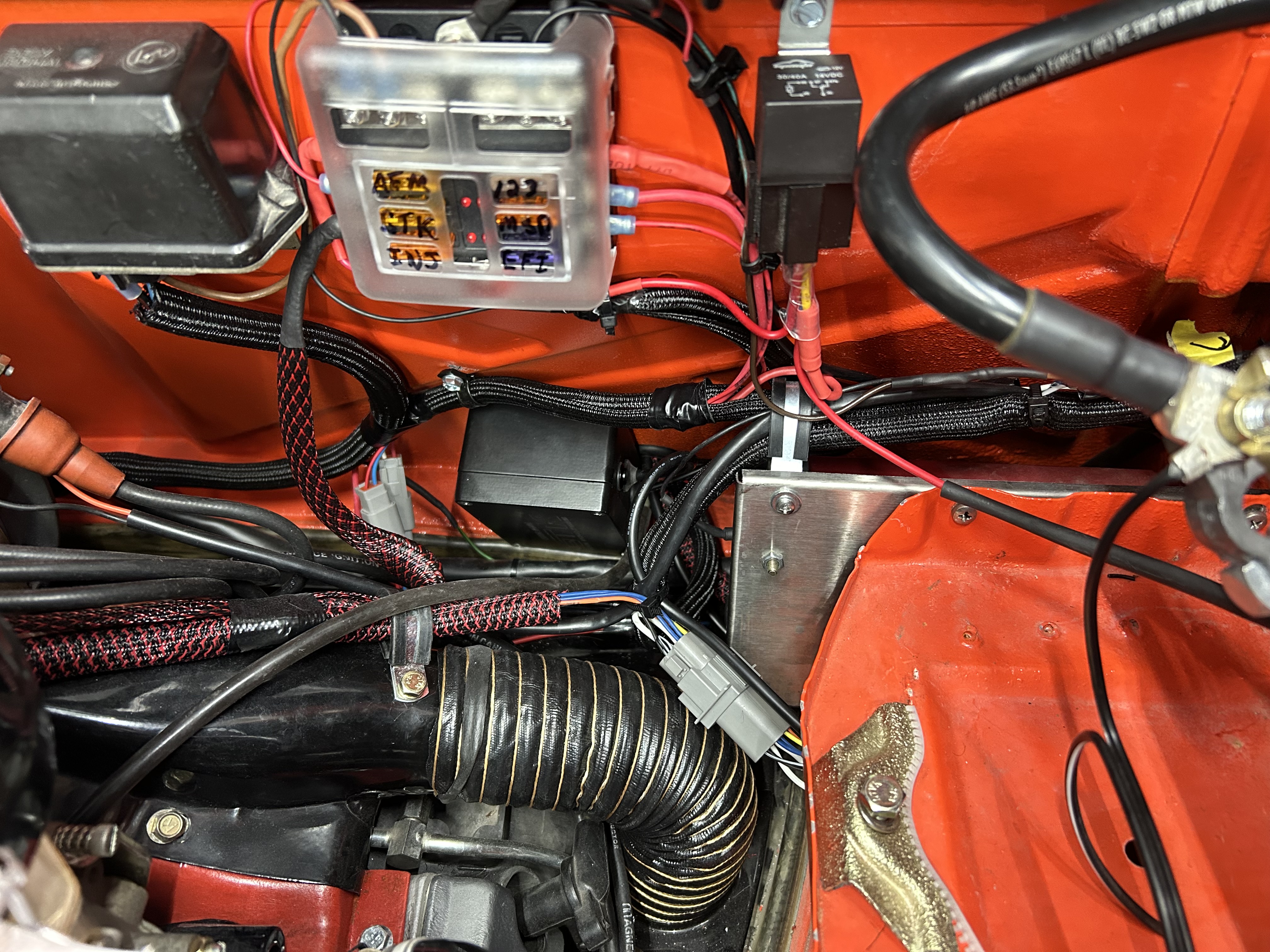

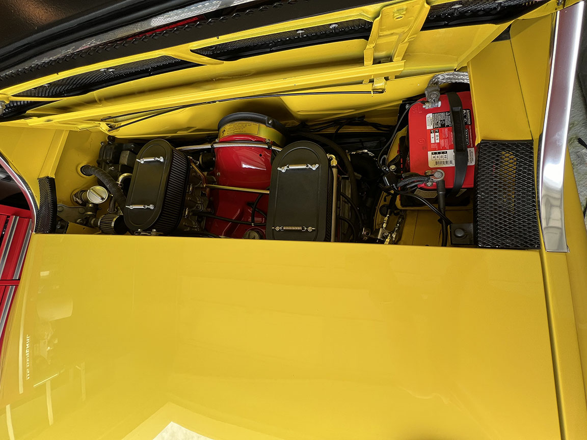

mb911
To give you all an idea. I will make sure the wiring is cleanClick to view attachment
mlindner
Nice job Ben, talk about clean and organized. The best I've seen. Mark
