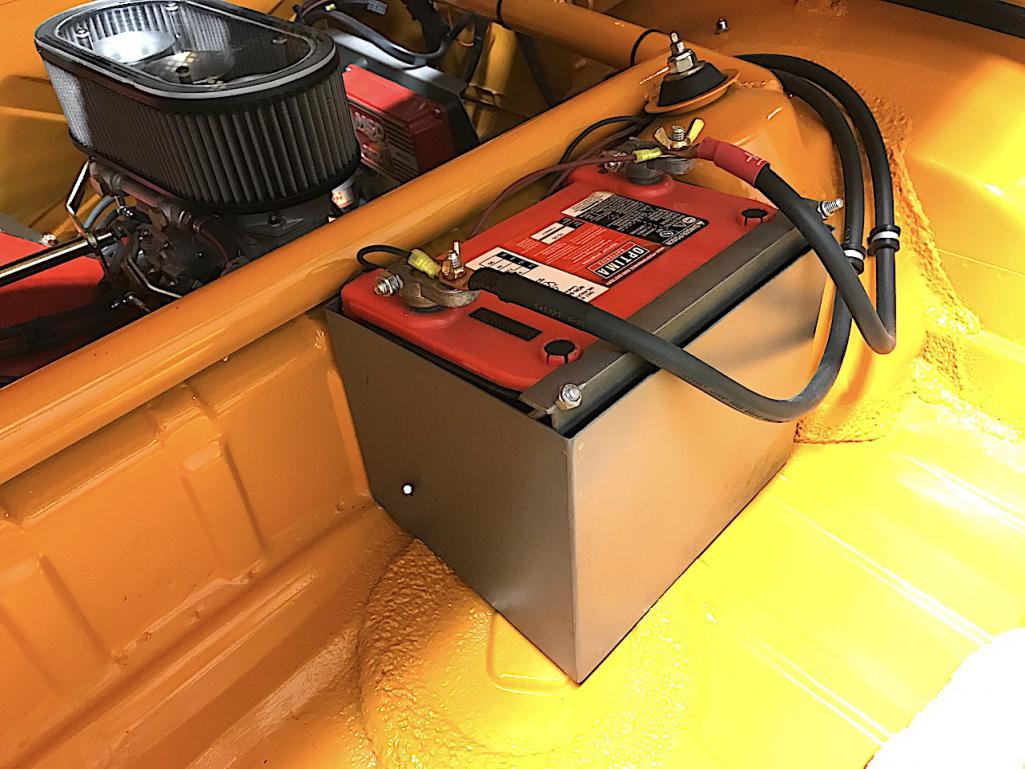

Ben, I'd stick to Optima. Had in many cars and never had to replace. Hard driving, no driving, long storage, in the 914 haven't even had to charge. Best, MarkAttached Image

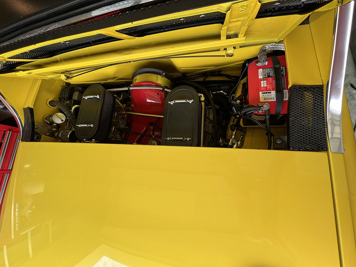

The red tops have worked well for me as long as I don't let them sit for too long
Red Top put in by PMB
Best Bob B
