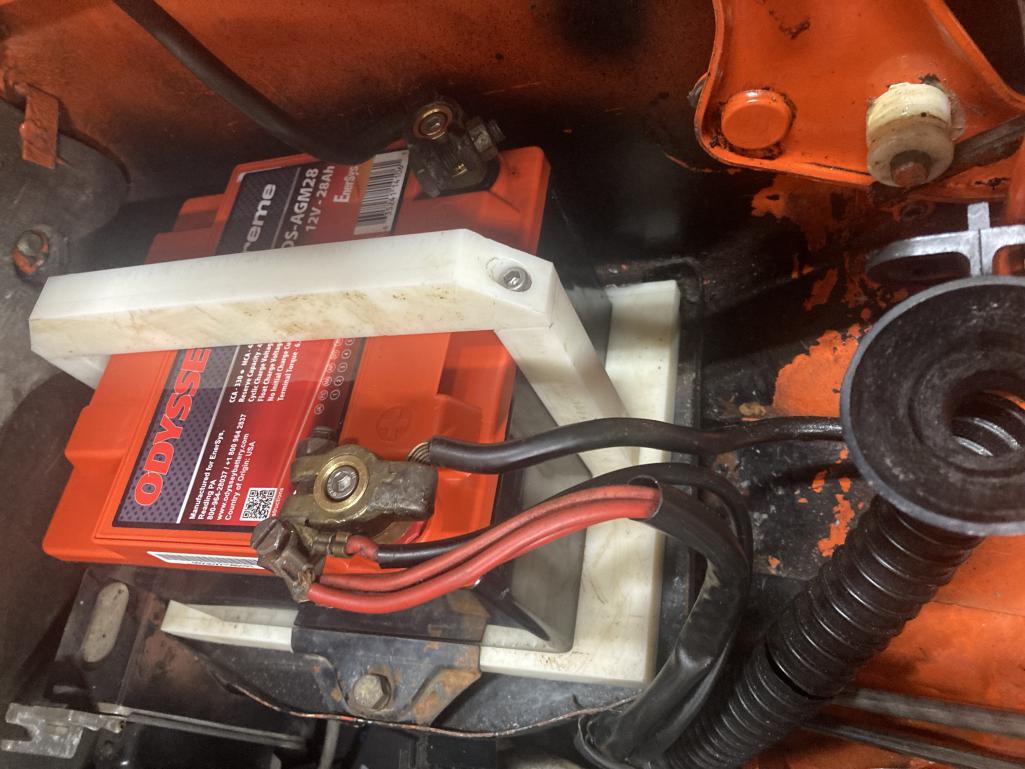

mb911   How do you attach conventional battery wiring to ...   Jun 13 2024, 04:30 AM

bkrantz   IMO there are two critical battery rules for 914s....   Jun 12 2024, 08:44 PM

mb911   Simple and easy I like that   Jun 13 2024, 04:31 AM
windforfun   The fewer the parts the better from a reliability ...   Jun 12 2024, 08:49 PM
mb911   To give you all an idea. I will make sure the wiri...   Jun 13 2024, 04:34 AM
mlindner   Nice job Ben, talk about clean and organized. The ...   Jun 13 2024, 04:42 AM
