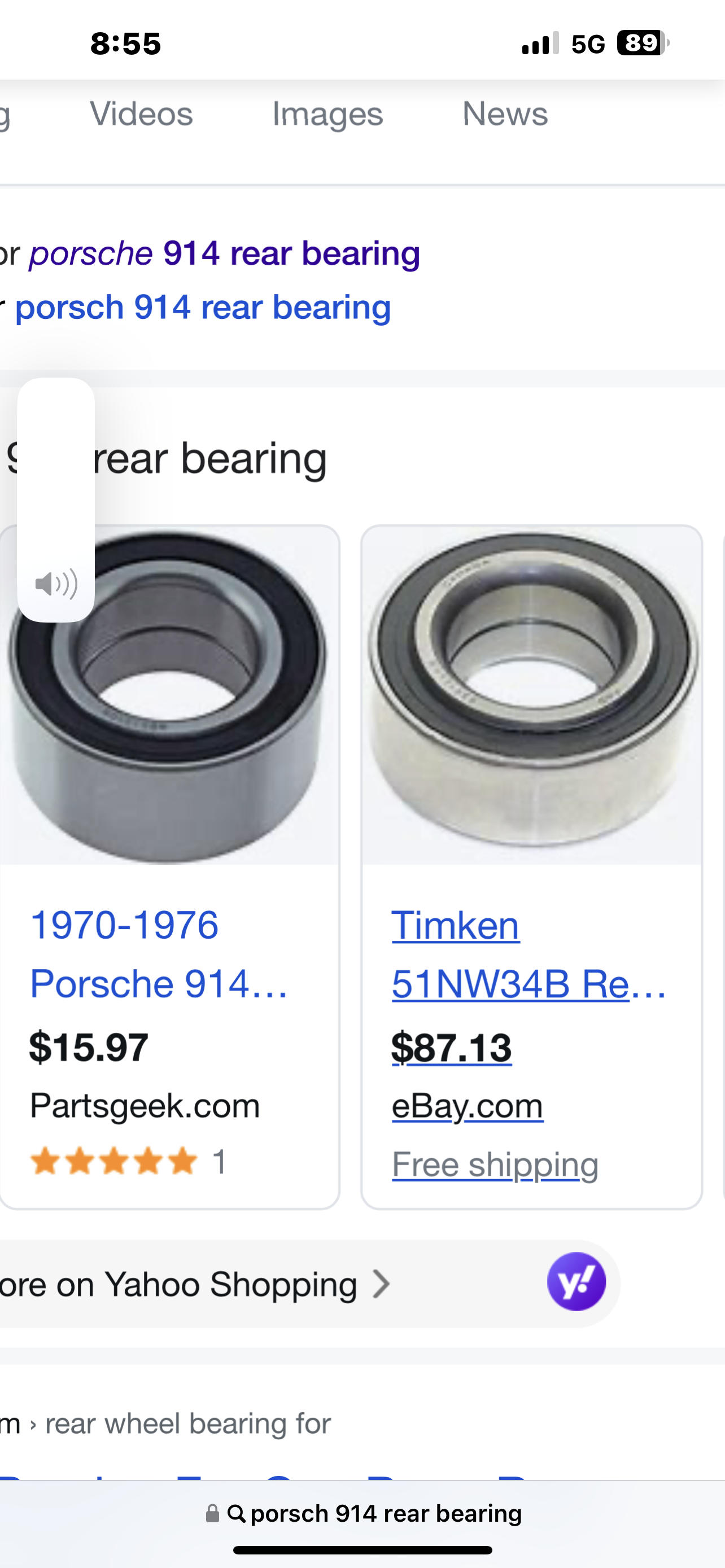

neilbardsley   This job was done on my car recently and the mecha...   Jun 10 2024, 05:32 AM
930cabman   This job was done on my car recently and the mech...   Jun 10 2024, 07:39 AM
neilbardsley   Yes he completed the job. I was just a bit surpri...   Jun 11 2024, 06:41 AM
rjames   Yes he completed the job. I was just a bit surpr...   Jun 11 2024, 10:19 AM
930cabman   I changed both awhile ago, had the bearings packed...   Jun 11 2024, 02:42 PM
jim_hoyland   What’s the life expectancy for a rear bearing ? ...   Jun 13 2024, 09:54 AM
Superhawk996   What’s the life expectancy for a rear bearing ?...   Jun 13 2024, 11:51 AM
jim_hoyland   Thanks; good info to know… :)   Jun 13 2024, 12:06 PM
