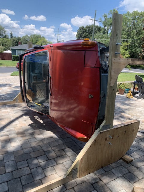

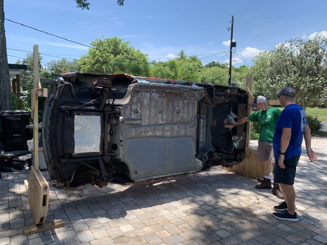

Sometimes a project reaches a tipping point…
Started the day off on all fours
(Jackstands of course)
A BIG THANKS to Peter and Wesley for their helping hands today!
I’m very grateful.
