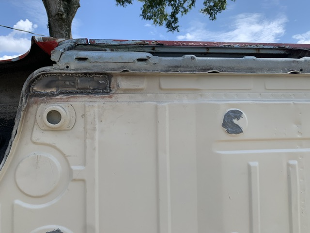

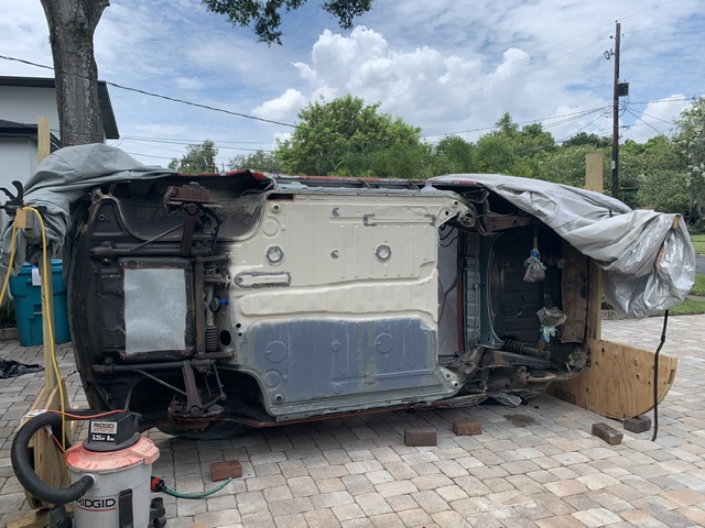

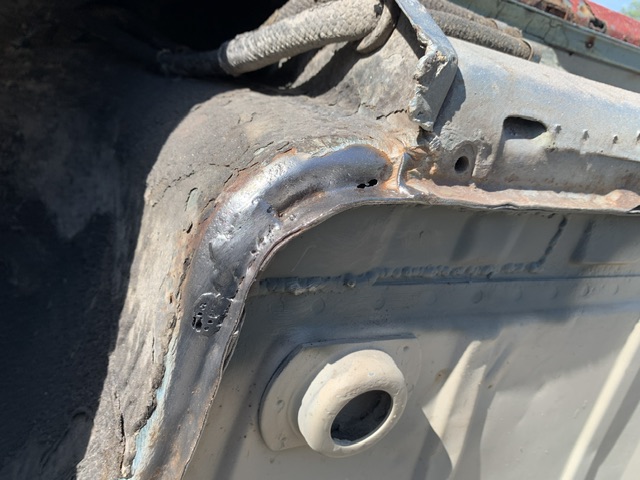

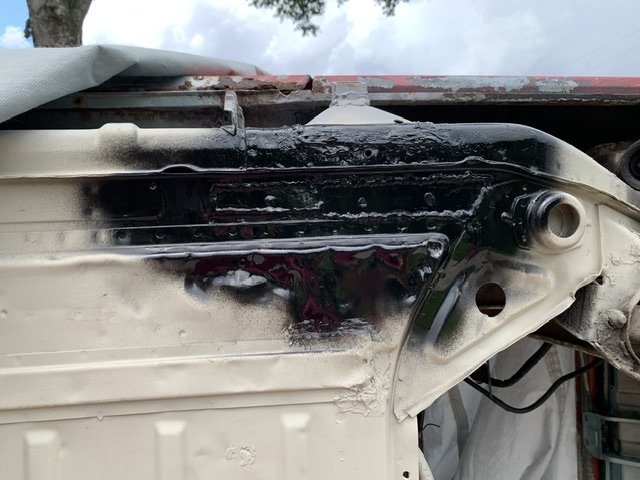

Between the rain (daily), family life, and regular job duties, I’ve been able to put in some work on the Teener. Having it on her side with full access to the floor has been incredibly productive even with dodging the daily rains.
Since I’ve already done the passenger floor (the hard way), I still needed to repair some rust spots on the driver side.
Patches are in. The floor and longs are nearing completion. Still need some seam sealer and an undercoating. The roll over jig has really helped my motivation getting back into these repairs.
