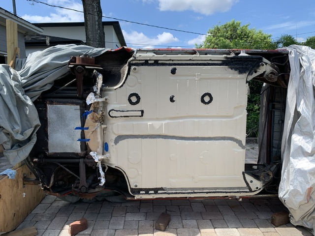

Kind of a wash out last week when outside of day job working hours. Missed the opportunity to work on the car over the weekend due to travel. But the rained missed us yesterday which left the car dry and was able to get the seam sealer on the underside.
After some cure time the next step will be to coat the floor. I bought the aerosol Raptor liner.
