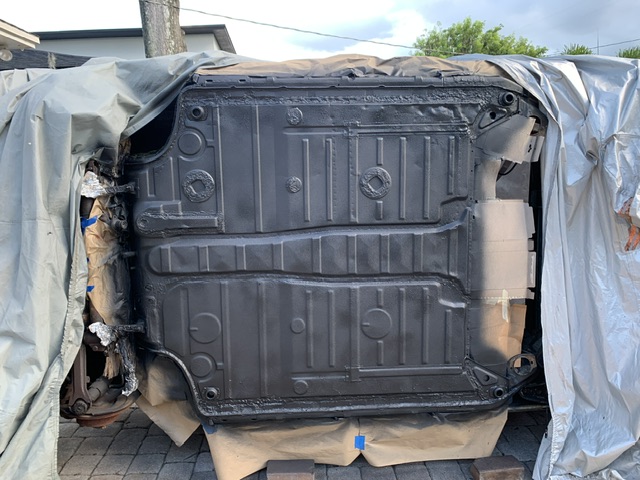

Rain delay today. Workshop closed.
But yesterday we dodged the rain and I was able to get the floor pans coated.
Used all four cans.
(I’d estimate two aerosol cans per wheel well for potential future use.)

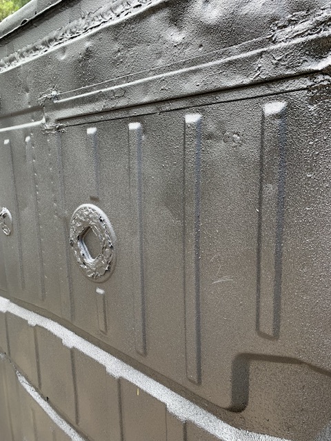

How it looks today not quite 24 hours later…
Seems good. Not yet fully cured but wasn’t even 24 hours when I tried to scratch at it.
I thought the texture in it would cover/hide some of the imperfections but no. It’s literally the bottom of the car so no big deal. It’s sealed and protected.
Happy to have made this milestone.
