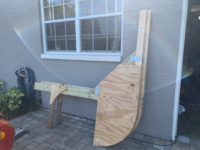

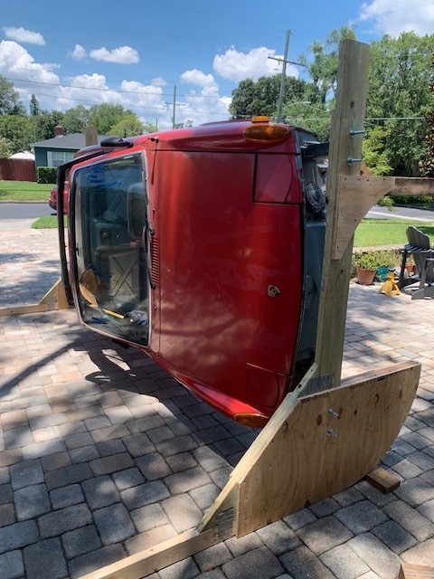

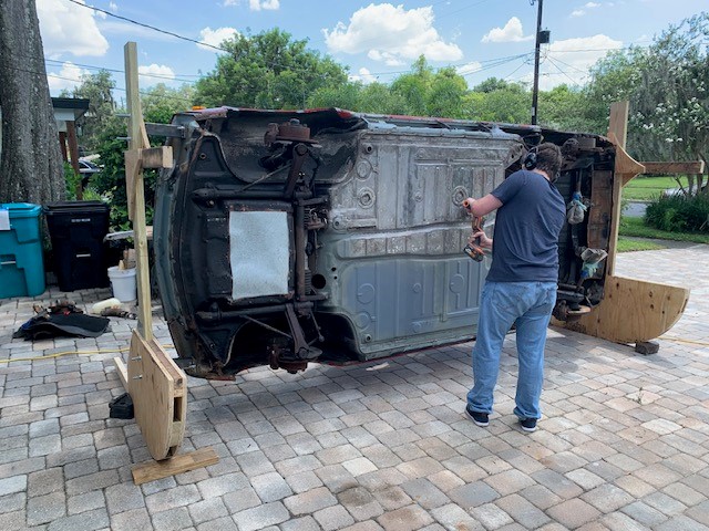

Roll over jig
I did not come up with this but couldn't be more pleased. (IMG:style_emoticons/default/aktion035.gif)
Let's give credit where due...
Website:
Restocar.com (IMG:style_emoticons/default/smilie_pokal.gif)
YouTube:
“914 Hillbilly tip-over jig” – https://www.youtube.com/watch?v=9QFZxzxtLJc
“WOODEN Tip Over Jig: How to Build One for your Car! (DIY)” – https://www.youtube.com/watch?v=1YIZdwXgSao
I won't post the plans, just go to the source, but I will attest that they work.
I only use the most modern of tools.

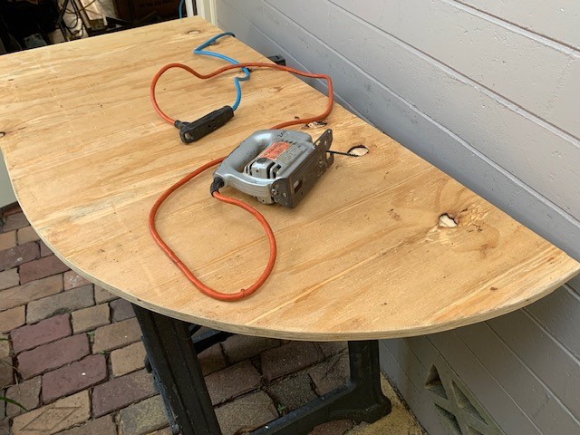

Adjustments to the design used in my application were:
1. Jigs are sandwiched with 3/4 plywood
2. Legs on rear jig (centerline to ground) are 1-inch longer than the front jig due to bumper locations. Front jig per plans.
3. All member intersections are reinforced (either by the plywood or a truss mending plate).
With a bare or mostly stripped shell, this design handles it with ease. And, I suspect one person would be able to flip it.
Not the case with what I did here. (IMG:style_emoticons/default/screwy.gif) The interior is out of the car, the drive train out, the wheels are off, doors, glass, and suspension remain and we were still able to rotate the car over but it is heavy to get started. It has been up for two weeks and is very stable up on its side.
My welded brackets that interface between the jig and the car need some TLC because I weld like (IMG:style_emoticons/default/stromberg.gif)
This has allowed me, I dare say, to finish the cabin's floor.
