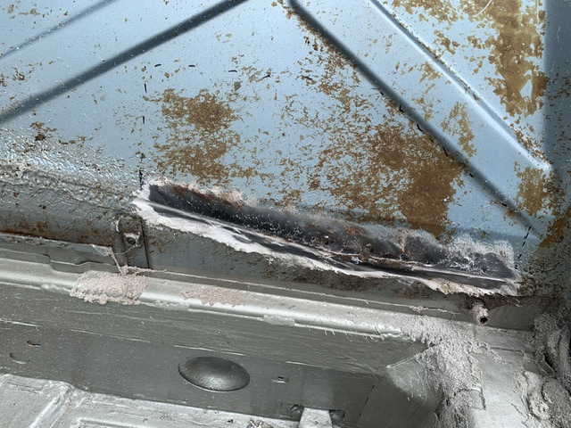

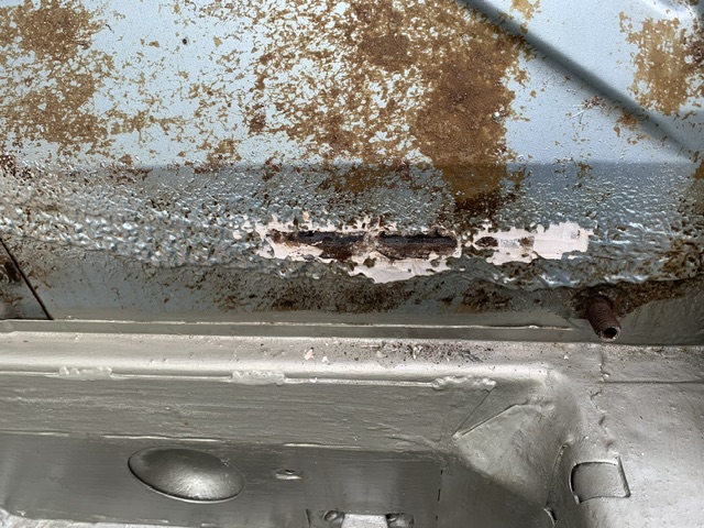

What’s behind your seam sealer? (IMG:style_emoticons/default/mad.gif)

seanpaulmc   What’s behind your seam sealer? :angry:   Jul 27 2024, 07:21 PM
