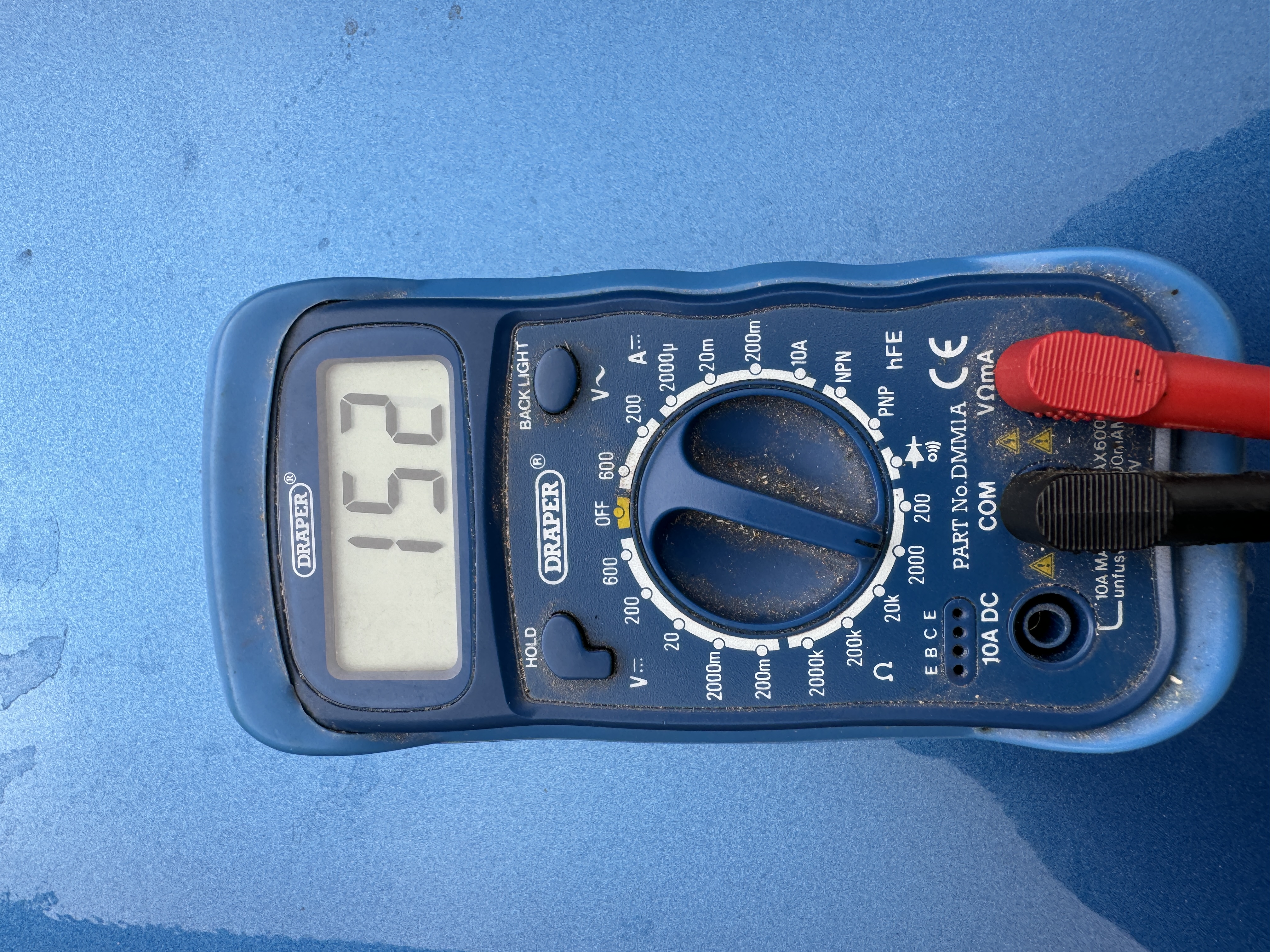

Car fired up first time. Not a miracle as it can do that. Took it for a run - was running really well, smooth. Used the car over a couple of days. Running great. Decided to change the oil and filter as it was still contaminated with fuel. Ran the car some more. All good. Ran around this morning doing a few errands. Went to take the car out this evening... won't start. Completely flooded. Oil contaminated with fuel again. (IMG:style_emoticons/default/headbang.gif)
Pulled the injector wires - cranked the car over 5 or 6 times and eventually it fired, ran for a few seconds then died. Plugged the injectors back in, car started. Ran it around to get it hot, running a bit ruff, then left it ticking over. Tick-over was 1500rpm rather than 1000rpm. Smells very rich.
Tested the CHT sender... this was the reading. Attached Image
