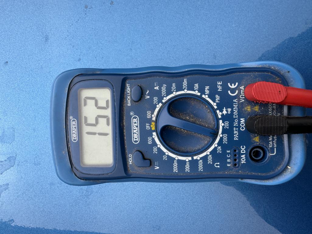

Tested the CHT sender... this was the reading. Attached Image

My car did this when I first got it.
An MPS begining to fail....cracked.
As far as the CHT....you need to note what temperature the OHMS reading was taken and for what CHT meaning what part number.

This was hot, not sure on specific temp but could measure next time. I did one at 60 degrees and it was right on the expected reading. It’s not the original sender but the standard replacement 1.7. That ends in 012.
Gonna start going through everything again methodically starting with MPS.
