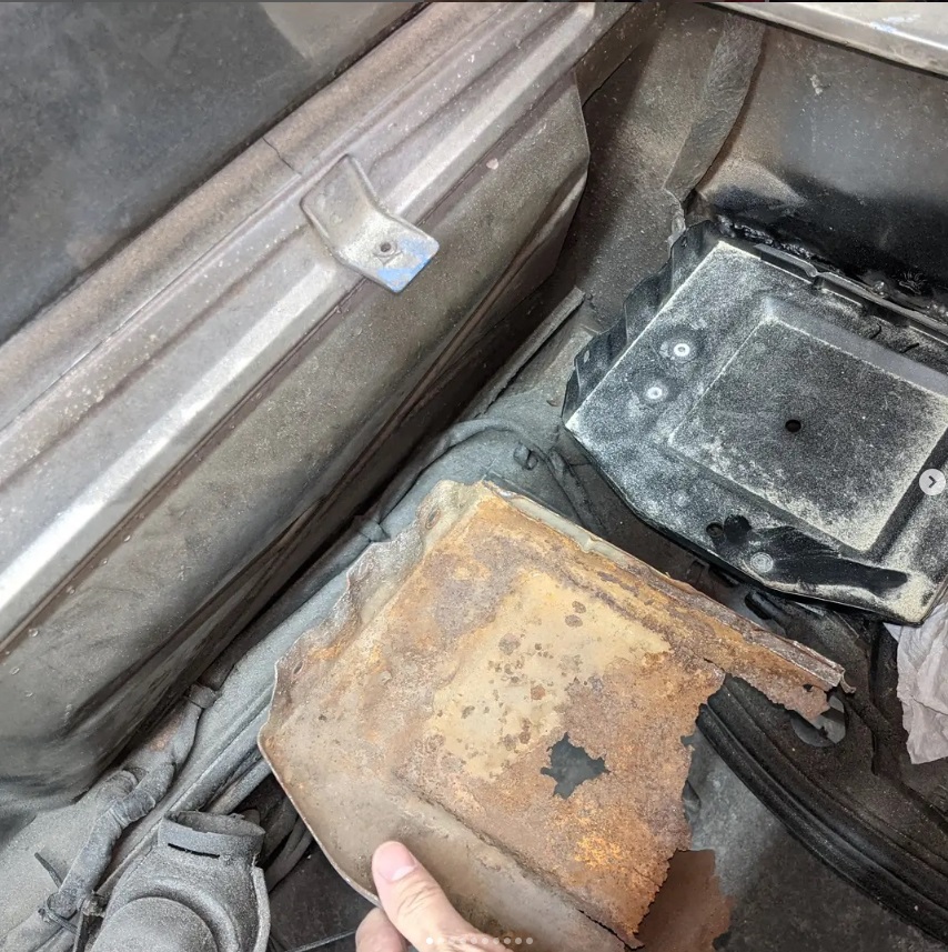

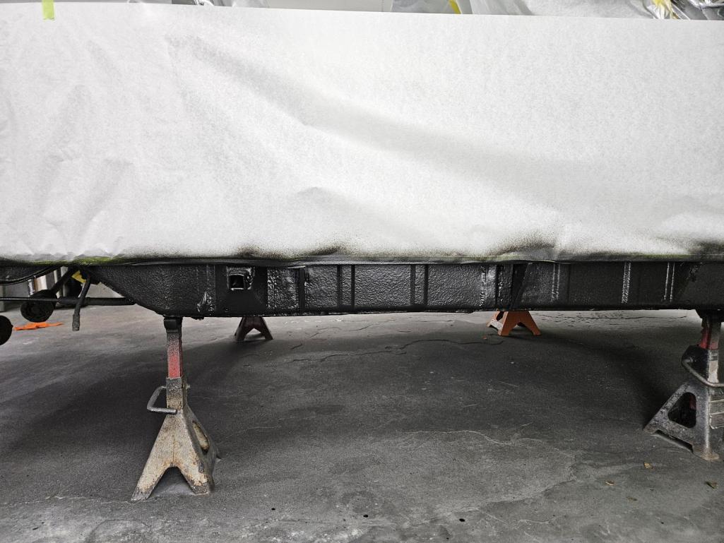

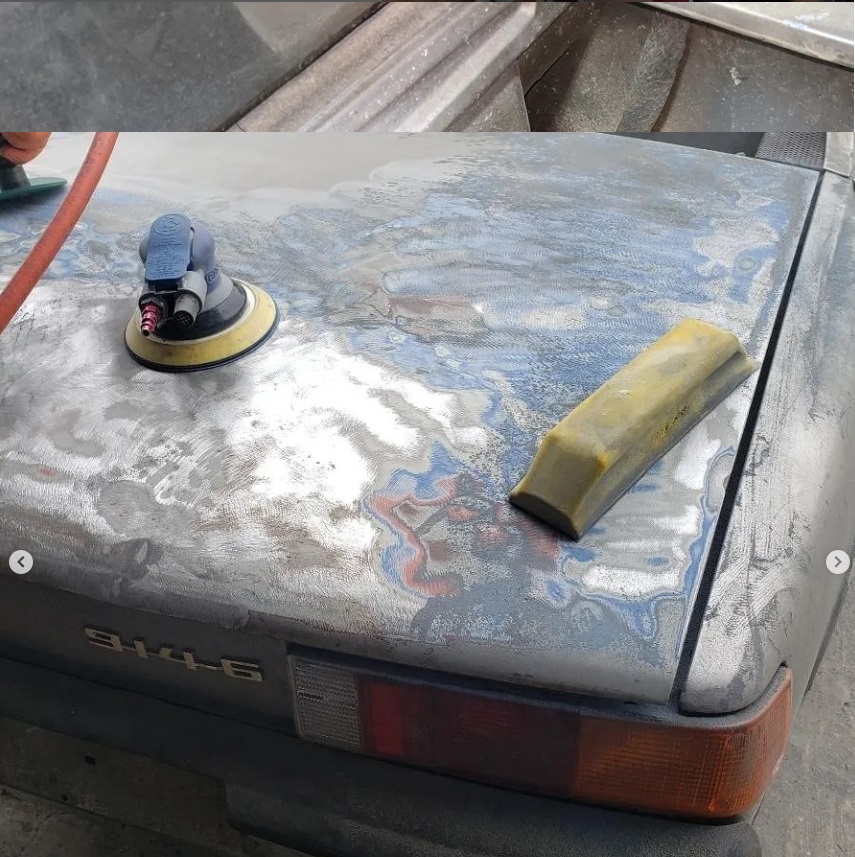

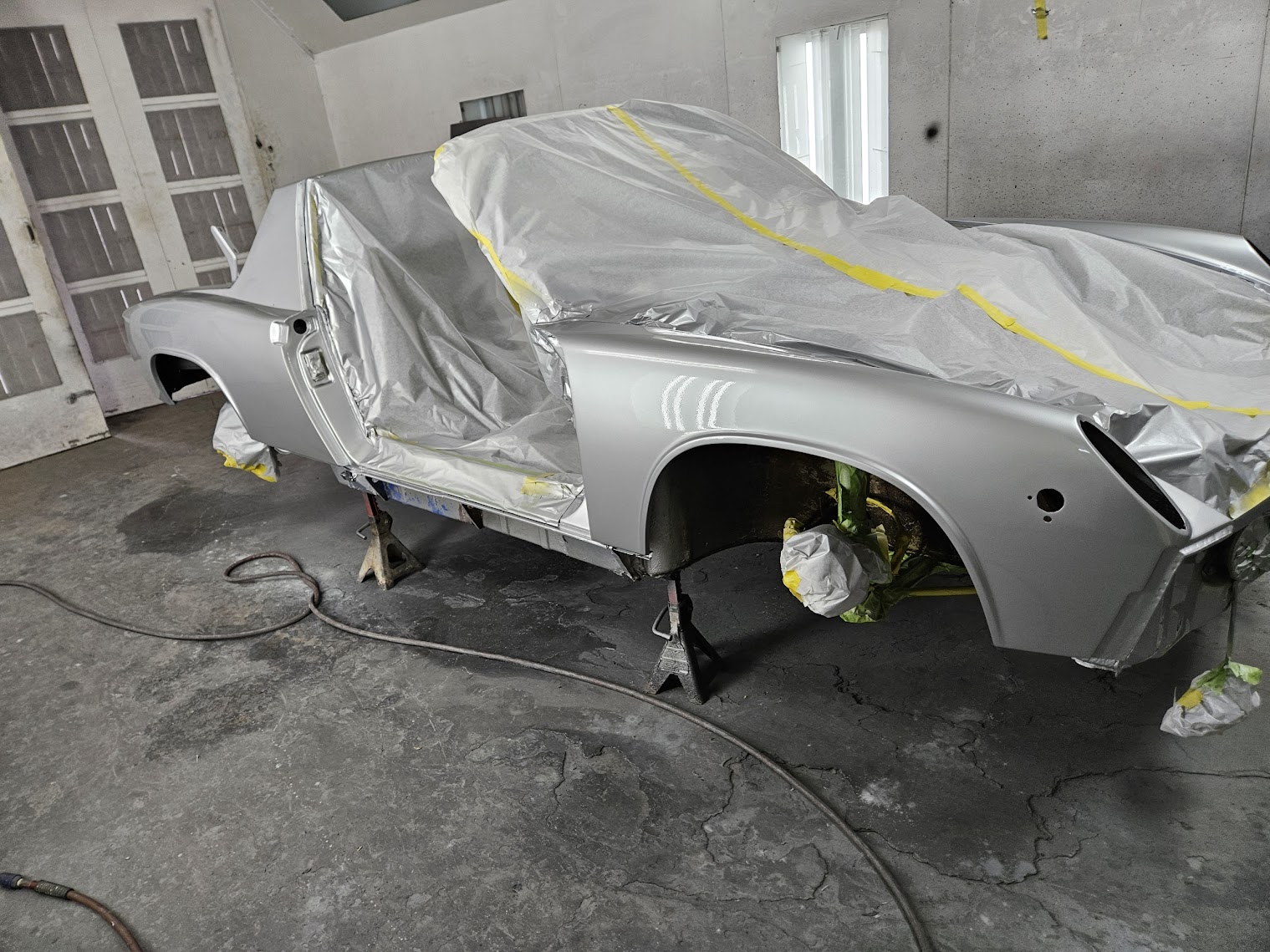

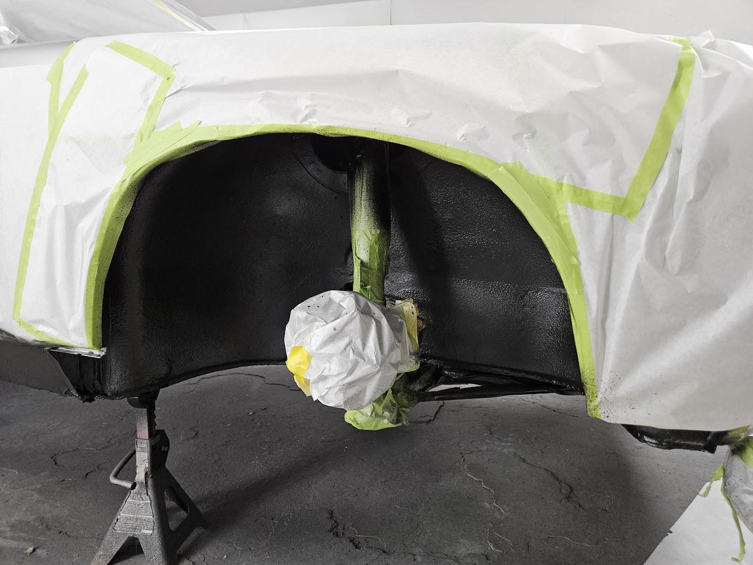

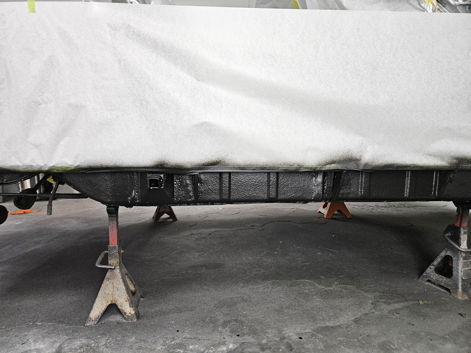

The original paint was not restored. The body was cleaned, dings pulled, sanded, sanded some more, primed, and painted the original L-96D / 925 with 3 coats of clear. Note: Not shown are the painted A-pillars, engine bay, decklid, and trunks. Floor pan also will receive treatment, and the firewall. Insulation is also the plan for the firewall (cab side).
While the paint was stripped, the entire car was scoured for rust, with extra attention to the longs. With the exception of the battery tray replacement, it was rust free. Although this was not a rotisserie job, it is through and through solid, evenly painted, and is examined.
Next on my agenda is cleaning the original hardware, remembering where certain parts go, cleaning the fuel tank, and replacing the lines. Does anyone have recommendations on how to proceed? I read that using a reel of standard rubber fuel was okay, but I was curious how accurate / value would be for the car?
