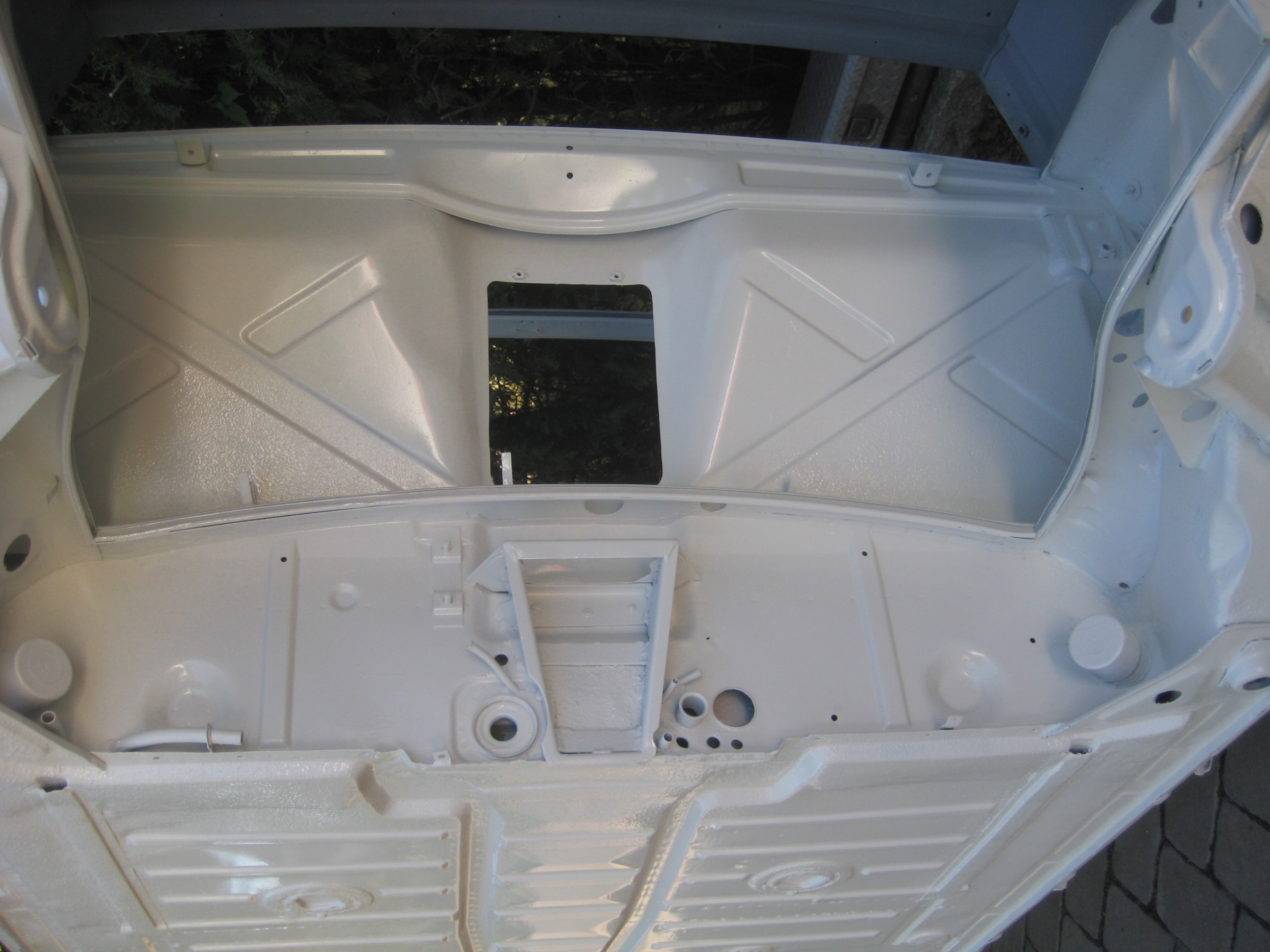

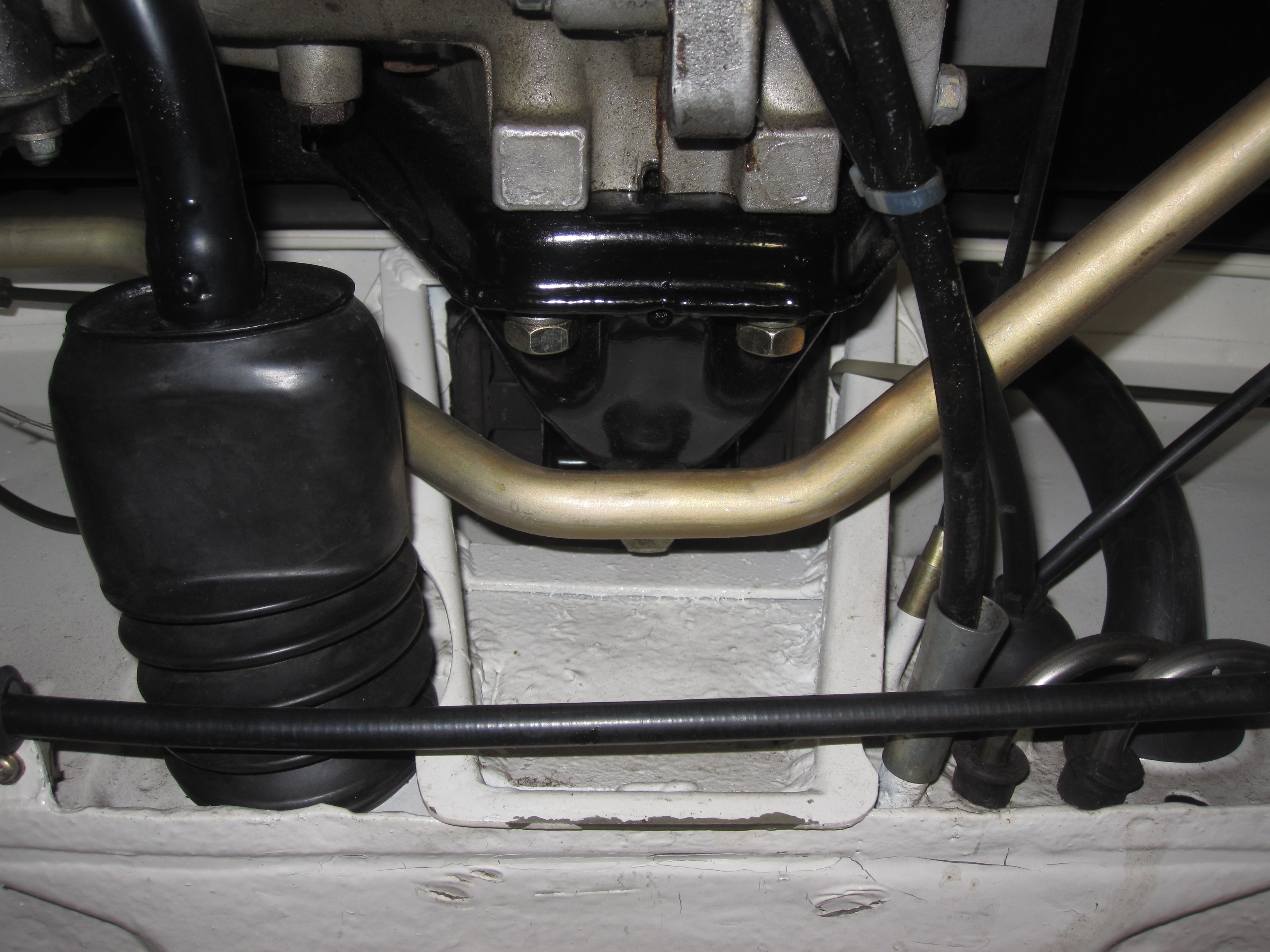

I never liked aftermarket mounts because they all required compromise of some sort.
To remedy this I fabricated a duplicate of the original bulkhead piece and located the
OEM parts to complete the set.
A repro of the original rubber part is now available.
If I had to do it again I'd get as close as possible to the original design using the copy
available but would re-inforce it much like the factory did
