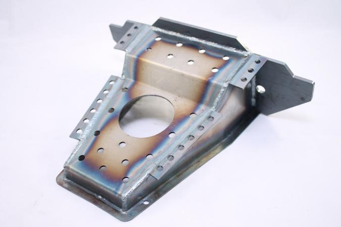

My pick for best one.
ClayPerrine
Aug 20 2024, 05:18 AM
I would agree with the above if you are staying with a small six. But you need to consider that you may want a bigger engine in the future. If you do, you want the stronger motor mount.
The Naroescape mount is really good, as is the Rich Johnson mount.

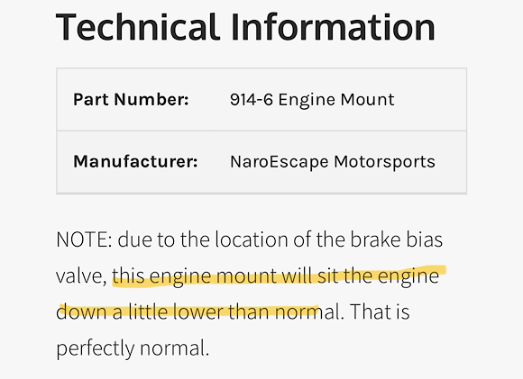

QUOTE(mepstein @ Aug 20 2024, 08:14 AM)
I tried the Naroescape mount. No bueno. Eventually I will remove it from my car and make the tin and everything fit properly bum not the first one to have problems with that mount but it sure was frustrating.
The nice thing about an oem style mount is everything fits the way it should.
Stronger is sort of a relative term.
Click to view attachmentTranslation: the engine doesn’t fit right . . . But that’s normal.
The OEM mount also locates on the bulkhead where there is internal structure to support it rather than just hanging off a layer of sheetmetal that is unsupported. NVH will be better with the OEM mount and OEM rubber isolation (i.e. less in cabin noise and vibration ) Nice that the OEM rubber isolation is now being reproduced.

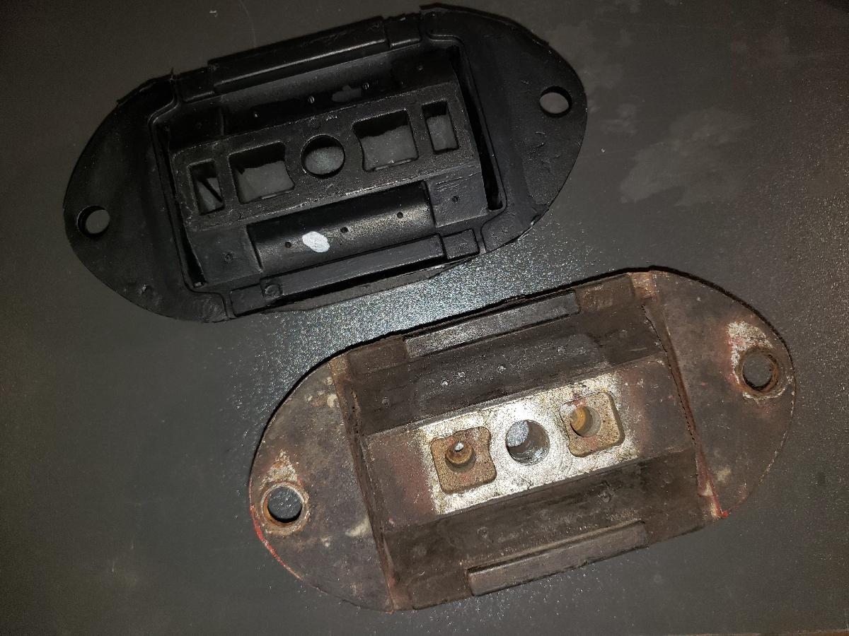

I used the MD mount and really like it. Installed easy, replicates the factory mount.
Aug 20 2024, 11:42 AM
QUOTE(NARP74 @ Aug 20 2024, 11:59 AM)
What is the difference between the 2 MD mount options?
One is a copy of an RJ mount, that was a copy of another mount. Uses two 911 engine mounts. The other is a copy of the Porsche OEM mount. Uses one large oem 914-6 mount.
The oem style fits the best (in my opinion) and needs the least amount of adaptation of lines, tin, shift rods, etc. Porsche did a good job on the design.

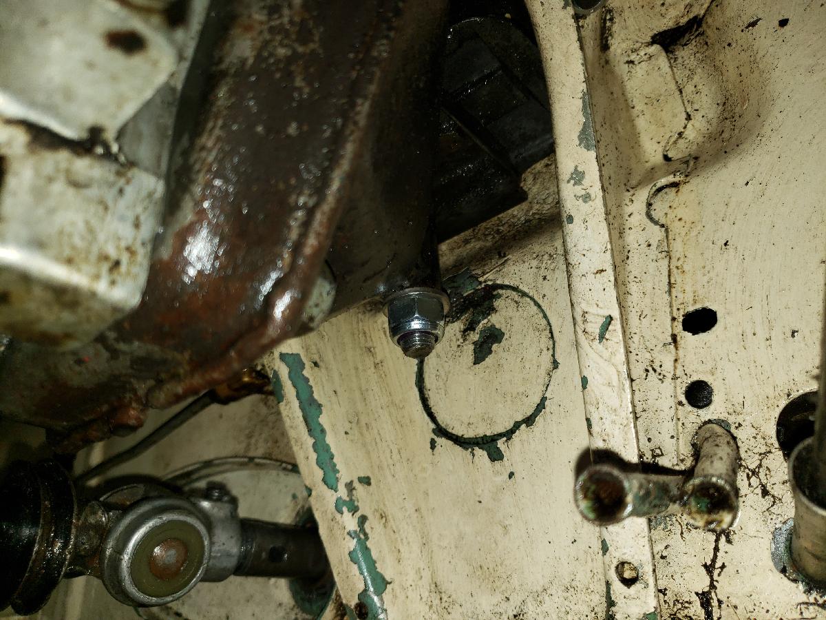

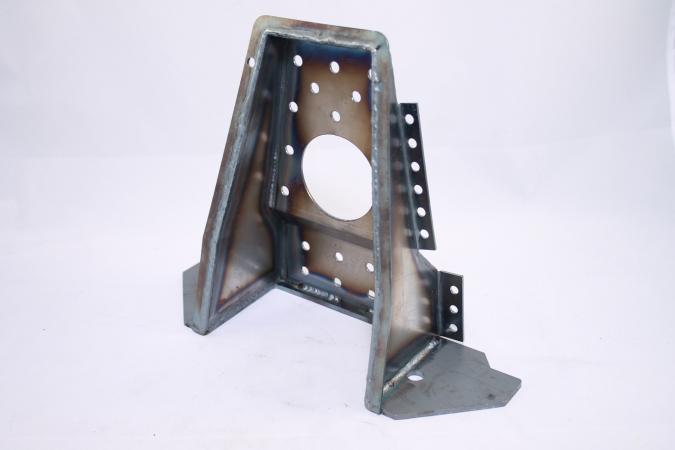

Just for some tight numbers onthe Naro mount; if you locate it where they indicate the motor is 0.85" low - this can be rectified by welding the mount upward by 0.85".
The other issue is that the Naro mount puts the engine 0.5" closer to the firewall so you would need to space off the mounts 0.5" from the firewall.
The Patrick mount has offsets too that I have measured that are similar, but not exactly the same - If someone wants those I could dig them up (it's all in CAD).
Aug 20 2024, 02:20 PM
QUOTE(live free & drive @ Aug 20 2024, 03:22 PM)
Yes, I had the space from firewall issue as well. Had to weld up some stock to make it work.

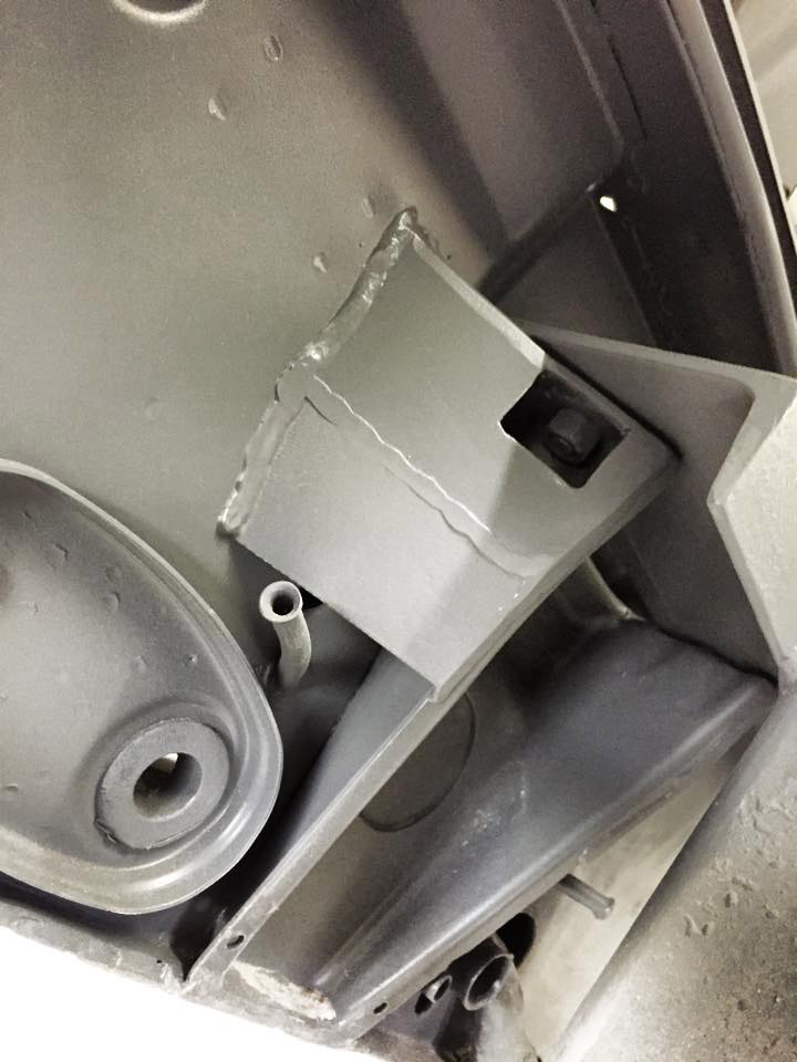

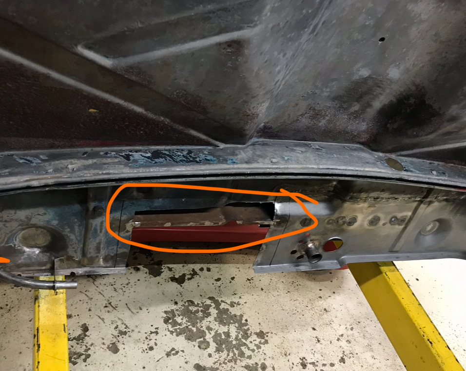

I am not sure where I heard this, but it is my understanding the factory six mount is not just welded to the outer firewall panel; I believe that is double-walled. But I guess we will find out how strong the stock 6 mount is; I still use my stock 6 mount and now have the 3.6 in my car. Granted, I only have about 200 miles on it so far, but time will tell if it holds up. (fingers crossed).
PS- I did have a MadDog mount (HB offered his up) we could have installed but I decided against it.
Superhawk996
Aug 21 2024, 08:20 AM
QUOTE(Cairo94507 @ Aug 21 2024, 09:44 AM)
Correct

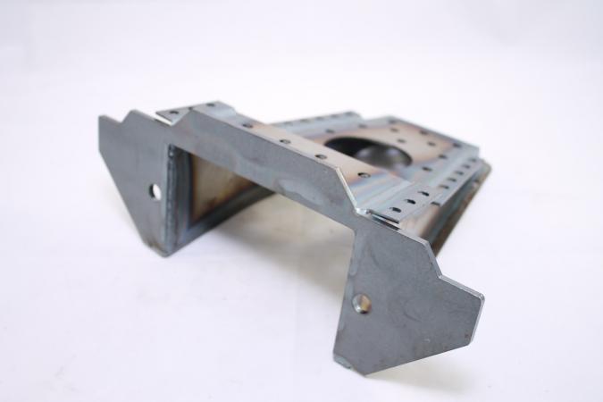

There is a hat shape channel reinforcement that connects the inner bulkhead to the outer bulkhead in the factory mount location. This adds a lot of strength and stiffness to the factory mounting area.
The Nano and PMS style mounts are supported by nothing but air behind the single layer of sheet metal outer bulkhead.
Click to view attachment Click to view attachment
