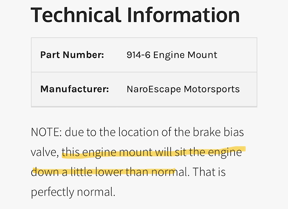

I’ll be using the maddog oem replica for a built 3.4 engine. I’ve already seen it in place on a hot 3.0 (300 hp on a Peter Dawe built engine) I tried the Naroescape mount. No bueno. Eventually I will remove it from my car and make the tin and everything fit properly bum not the first one to have problems with that mount but it sure was frustrating.
Stronger is sort of a relative term. Has the oem mount proven to be inadequate for big engines or is that just your perception. I have seen big engines in real sixes without issues. Some of them get flogged pretty hard on the track.
The nice thing about an oem style mount is everything fits the way it should.

QUOTE(mepstein @ Aug 20 2024, 08:14 AM) *
Translation: the engine doesn’t fit right . . . But that’s normal.
The OEM mount also locates on the bulkhead where there is internal structure to support it rather than just hanging off a layer of sheetmetal that is unsupported. NVH will be better with the OEM mount and OEM rubber isolation (i.e. less in cabin noise and vibration ) Nice that the OEM rubber isolation is now being reproduced.

QUOTE(Superhawk996 @ Aug 20 2024, 08:47 AM) *
Not only does the engine tin gap about an inch but it barely cleared the shift rod and affected some of the hard brake lines. It might work for some people, not me.

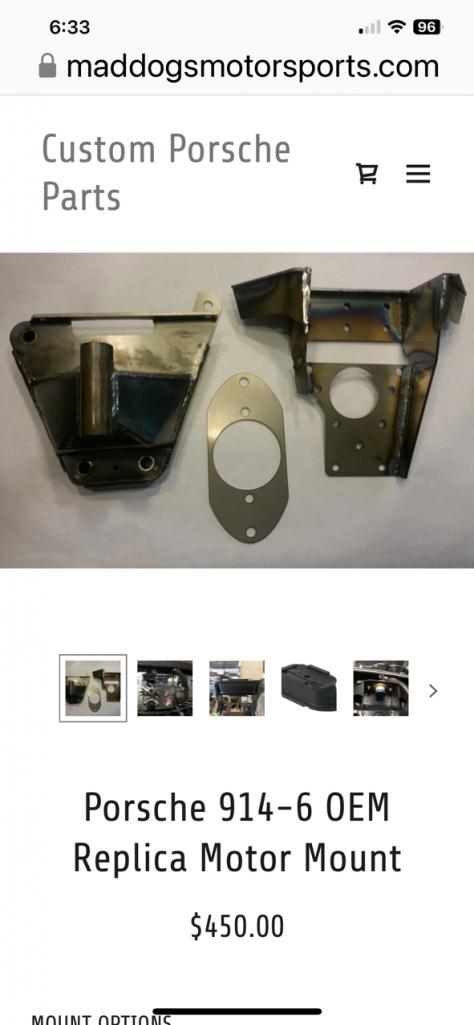

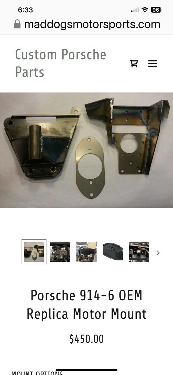

post Aug 20 2024, 11:42 AM
914-6 GT in waiting
Posts: 20,538
Joined: 19-September 09
Member No.: 10,825
QUOTE(NARP74 @ Aug 20 2024, 11:59 AM) *
What is the difference between the 2 MD mount options?
One is a copy of an RJ mount, that was a copy of another mount. Uses two 911 engine mounts. The other is a copy of the Porsche OEM mount. Uses one large oem 914-6 mount.
The oem style fits the best (in my opinion) and needs the least amount of adaptation of lines, tin, shift rods, etc. Porsche did a good job on the design.

post Aug 20 2024, 01:22 PM
Posts: 211
Joined: 29-June 16
From: New Hampshire
Member No.: 20,159
Just for some tight numbers onthe Naro mount; if you locate it where they indicate the motor is 0.85" low - this can be rectified by welding the mount upward by 0.85".
The other issue is that the Naro mount puts the engine 0.5" closer to the firewall so you would need to space off the mounts 0.5" from the firewall.
The Patrick mount has offsets too that I have measured that are similar, but not exactly the same - If someone wants those I could dig them up (it's all in CAD).

QUOTE(live free & drive @ Aug 20 2024, 03:22 PM) *
Yes, I had the space from firewall issue as well. Had to weld up some stock to make it work.
