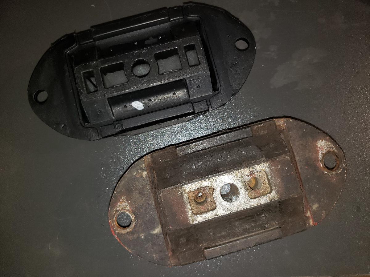

post Aug 21 2024, 09:56 AM
Posts: 2,738
Joined: 12-March 04
From: Chicagoland
Member No.: 1,785
also have been using URO HD engine mount (top) for past 5 seasons without issue
