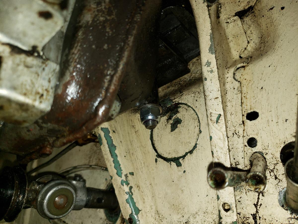

Finally getting ready to send my '71 I've had since new to the restoration boys at Stalltek for paint and six conversion work.
I've never figured out the search function so would like opinions on the best bulkhead engine mount options- want a factory look and will be doing a mild 2.4 E engine build. The car has already been converted to a side shifter some 30 years ago... getting the sheet metal I got here on a group buy powdercoated as we speak.
Have at it guys...

I have been racing my car for 15 seasons with the original engine mount with zero issues. before I owned the car it was raced in IMSA for 5 seasons with a 3L RSR spec engine.

mate914   A smaller engine like yours, defiantly get the ori...   Aug 19 2024, 07:00 PM
brant   Agreed You want the right original look Stock or...   Aug 19 2024, 07:23 PM

ClayPerrine   I would agree with the above if you are staying wi...   Aug 20 2024, 05:18 AM
mepstein   I would agree with the above if you are staying w...   Aug 20 2024, 06:14 AM
Superhawk996   I tried the Naroescape mount. No bueno. Eventuall...   Aug 20 2024, 06:47 AM

ClayPerrine   I do not like the fact that the front of the motor...   Aug 20 2024, 08:09 AM
Superhawk996   Keep in mind OP is running a 2.4L High HP brings...   Aug 20 2024, 09:18 AM
ClayPerrine   Keep in mind OP is running a 2.4L High HP bring...   Aug 21 2024, 05:12 AM

NARP74   What is the difference between the 2 MD mount opti...   Aug 20 2024, 09:59 AM
mepstein   What is the difference between the 2 MD mount opt...   Aug 20 2024, 11:42 AM
live free & drive   Just for some tight numbers onthe Naro mount; if ...   Aug 20 2024, 01:22 PM
mepstein   Just for some tight numbers onthe Naro mount; if...   Aug 20 2024, 02:20 PM
Superhawk996   Just for some tight numbers onthe Naro mount; i...   Aug 20 2024, 03:27 PM
