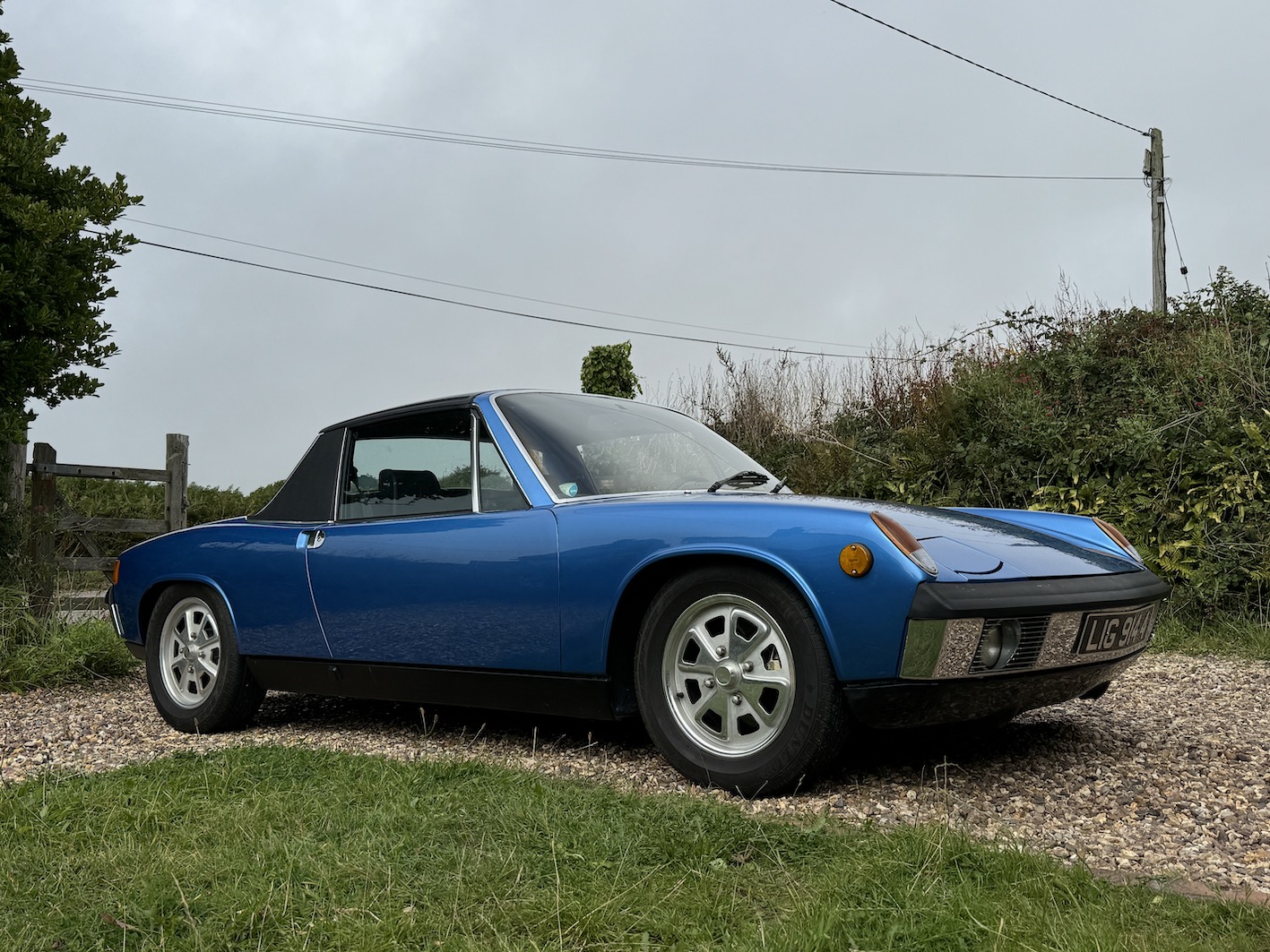

Halfnelson
post Aug 22 2024, 08:54 AM
Posts: 72
Joined: 31-July 17
From: Cornwall
Member No.: 21,303
Region Association: England
QUOTE(ctc911ctc @ Aug 22 2024, 02:01 PM) *
Jeff is the best - and despite his modesty, he IS THE EXPERT! (IMG:style_emoticons/default/beerchug.gif)
Yes, big thanks to Jeff. Took the car out today, drove it like I stole it. Got it good and warmed up. Restarts, idles, doesn't stink of fuel.
Thanks also to everyone who offered advice on this thread. Been a long road. Now I can get down to the small jobs that need doing. (Fingers crossed!!!!)
