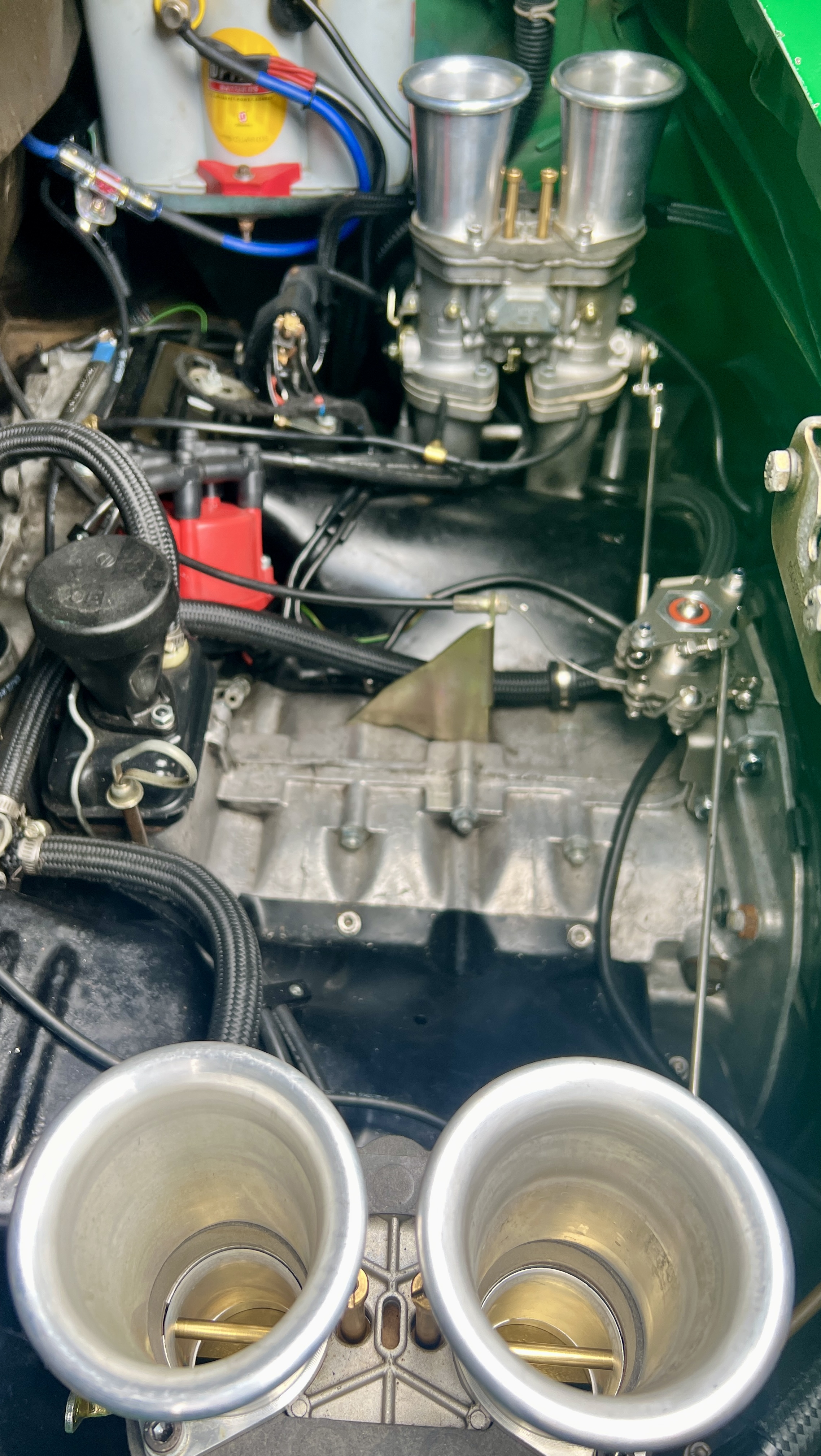

Lets bring back very old posts on carb questions.
I am istalling a vintage speed linkage, but apparently is not completely designed for a mid engine type IV motor.
Need some solutions on the throttle cable support. You will see my old cable holder in the center, and also see my weber update kit, CB Performance distributor, black box, and 3,5” velocity stacks.
