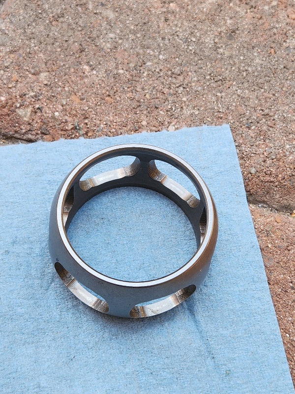

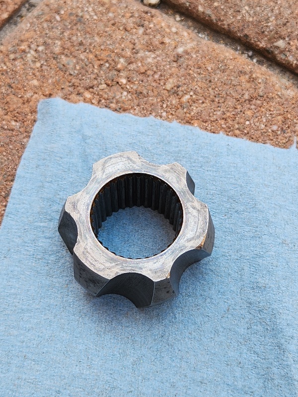

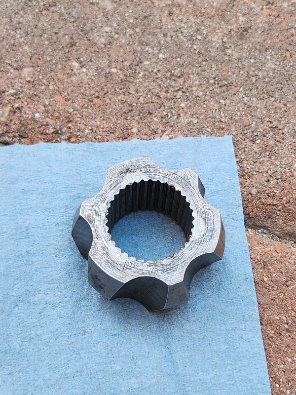

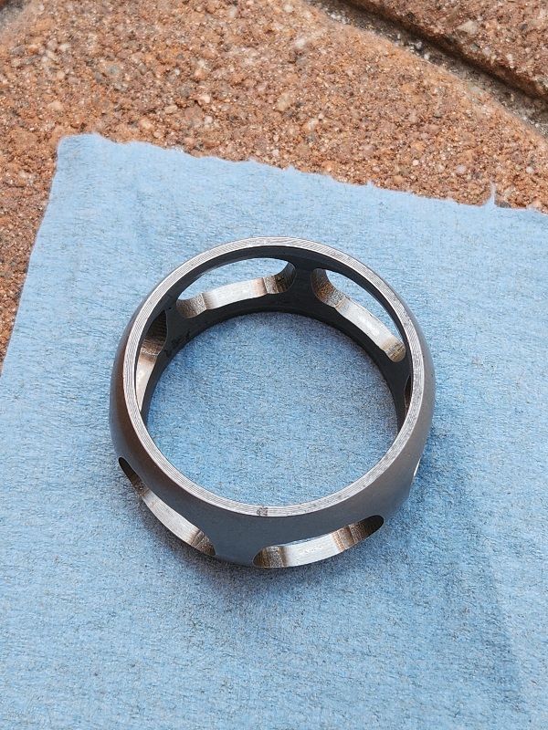

Went to rebuild the CVs on the other axle and the inner race doesn't have a side with bevel, and I do not see obvious wear in the shape of the washer. One side has stamping marks, other side does not. Is there another tell tale sign of which side goes against the concave washer?
Also, I noticed the cage "edge" has one edge that is more flat than the other. Is the more flat side supposed to face the concave washer?
Thank you!
Side with no stamping
Side with stamping
Wider edge on race
Narrow edge on race

Chi-town   Side with no stamping goes to the shaft Thinner ed...   Aug 26 2024, 09:28 PM
narino   @Chi-town - Thank you, Dylan! [b]@[url=htt...   Aug 27 2024, 09:14 AM
