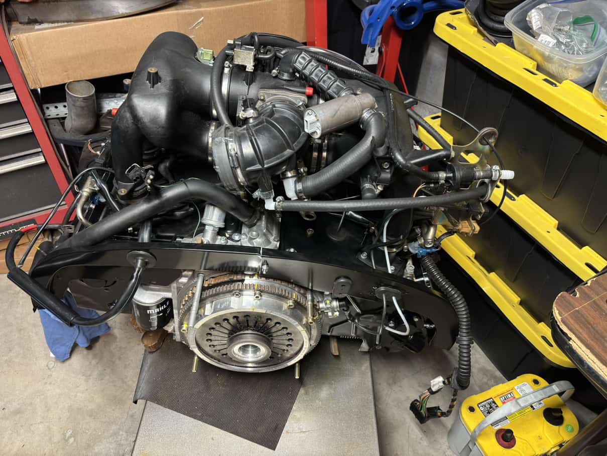

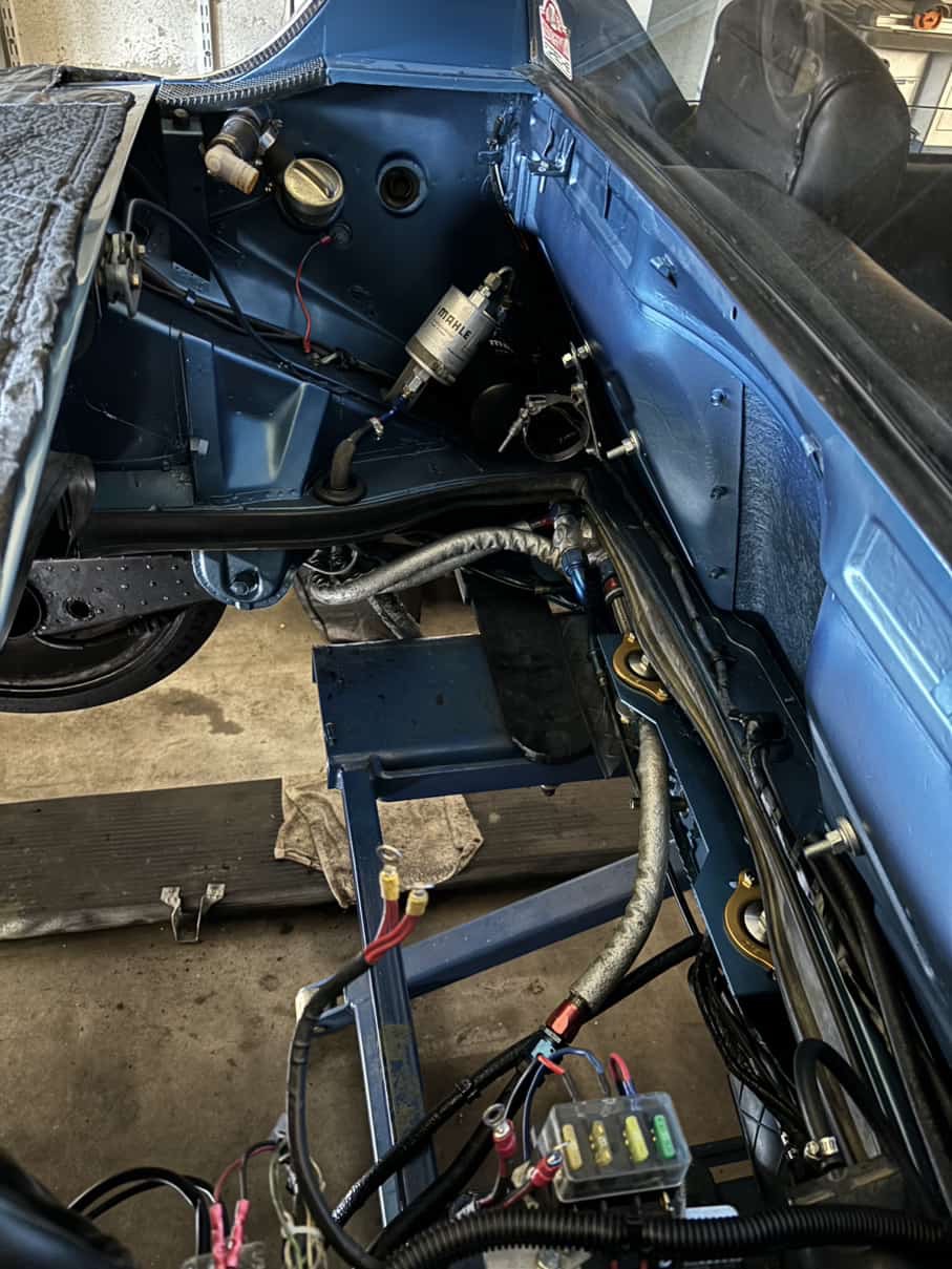

Hard to find time for this project, but getting closer. Tin done, wiring done, engine compartment redone. Next step install drivetrain. Hopefully this weekend.

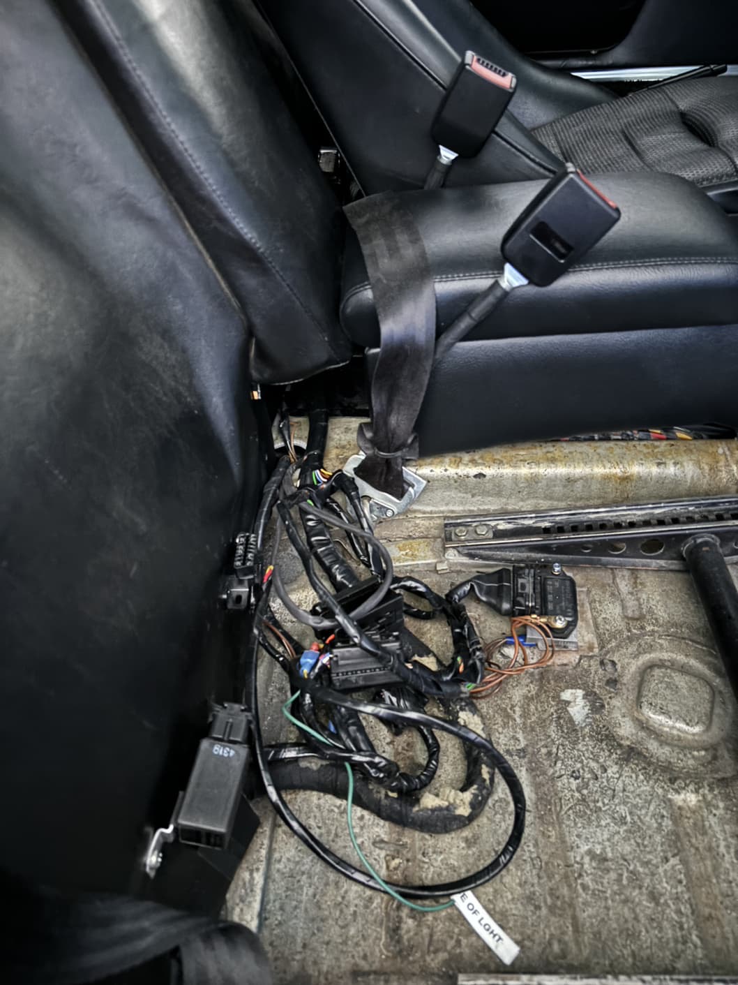

QUOTE(Steve @ Aug 23 2024, 09:41 AM) *
Hard to find time for this project, but getting closer. Tin done, wiring done, engine compartment redone. Next step install drivetrain. Hopefully this weekend!
That wire mess behind the seat is the Patrick Motorsports wiring harness adapter.
I made my own for the 3.2, but the 3.6 is a mess. All that crap to just four wires to the 914. Battery, ignition key positive, tachometer and fuel pump. Worth every penny to not have to figure it out.

Steve   I trimmed the MB911 tin to fit my 3.6 and cut piec...   Mar 17 2024, 06:43 PM
Steve   I trimmed the MB911 tin to fit my 3.6 and cut pie...   Mar 28 2024, 09:46 AM
