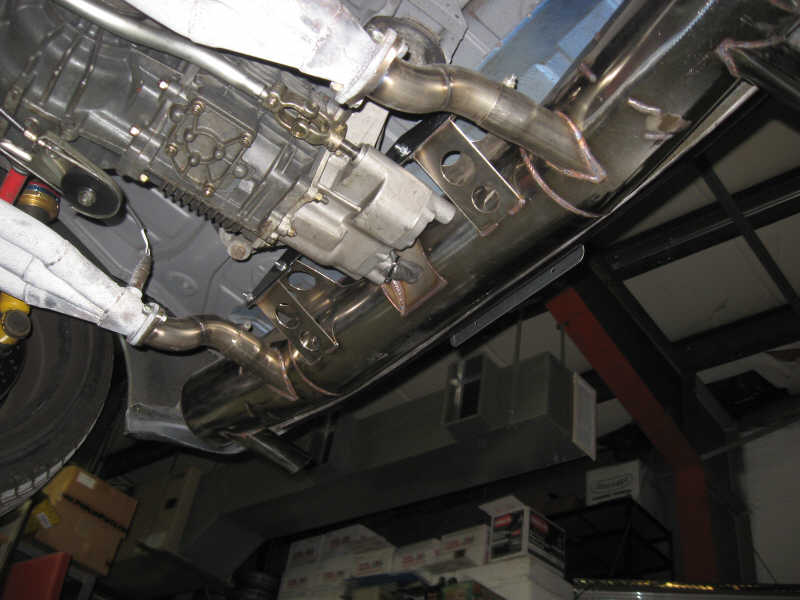

arbitrary   This is what my current system looks like. I...   Aug 26 2024, 02:41 PM
