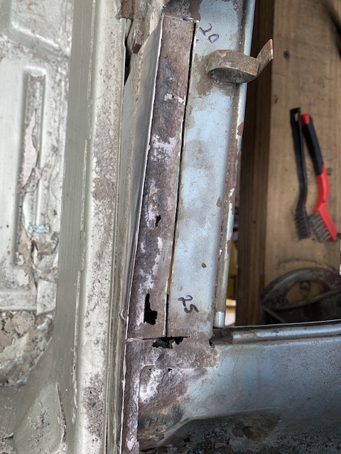

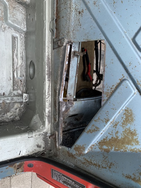

seanpaulmc   Looking to the weekend ahead and hoping to put in ...   Aug 27 2024, 09:27 AM
