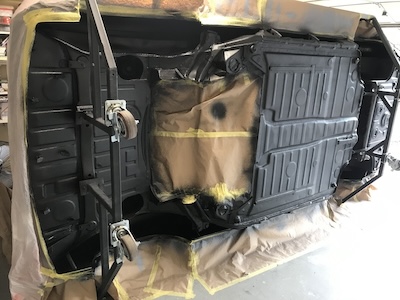

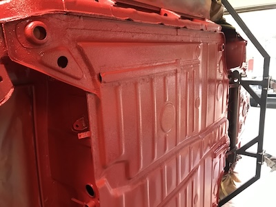

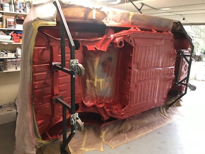

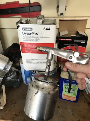

[Not trying to hijack the thread here with my pics] Thought I'd present another option. On my last 914 I used a paintable 3M undercoating followed a PPG's [Bahia Red] 2-stage paint. Didn't have to tint anything. It was all the same paint/color as the rest of the car.
