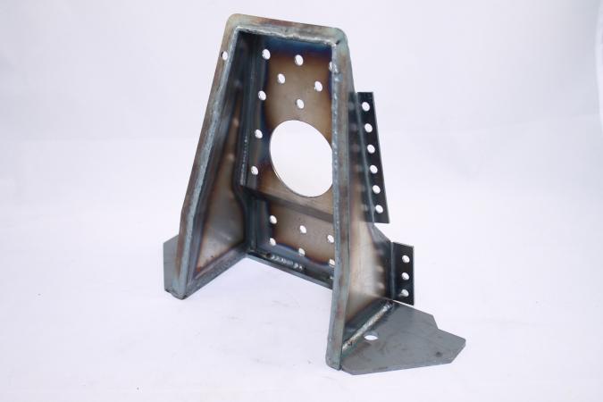

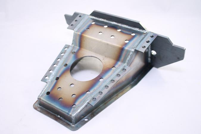

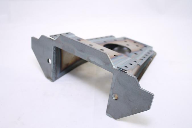

Has anybody used the chassis mount from Mittelmotor:
Any Thoughts?

live free & drive   Has anybody used the chassis mount from Mittelmoto...   Aug 27 2024, 01:30 PM
930cabman   Has anybody used the chassis mount from Mittelmot...   Aug 27 2024, 05:45 PM
