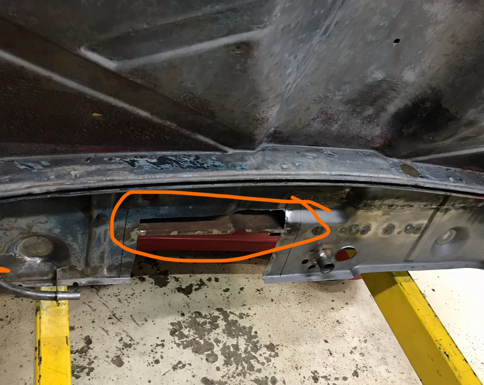

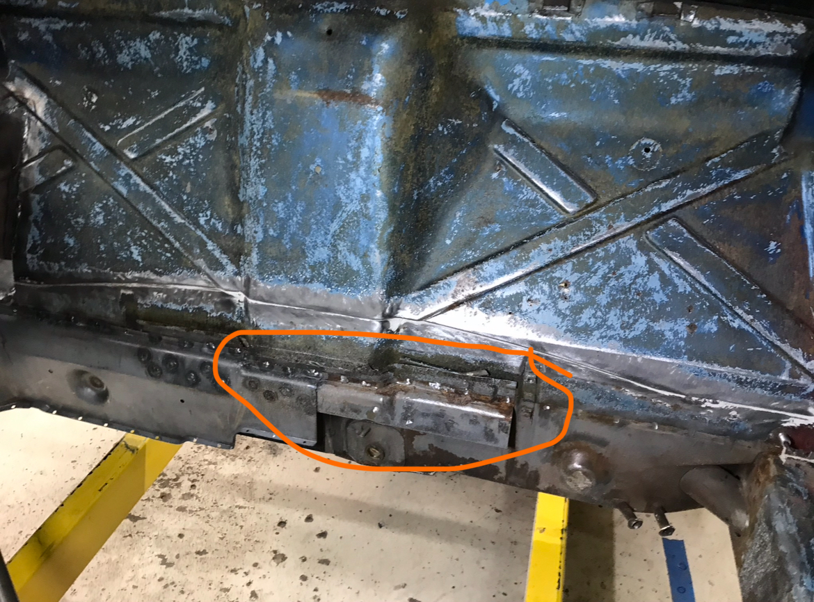

QUOTE(Cairo94507 @ Aug 21 2024, 09:44 AM) *
I am not sure where I heard this, but it is my understanding the factory six mount is not just welded to the outer firewall panel; I believe that is double-walled.
Correct
There is a hat shape channel reinforcement that connects the inner bulkhead to the outer bulkhead in the factory mount location. This adds a lot of strength and stiffness to the factory mounting area.
The Nano and PMS style mounts are supported by nothing but air behind the single layer of sheet metal outer bulkhead.
