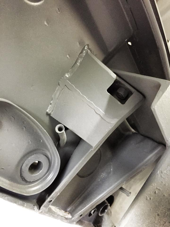

burton73
post Aug 27 2024, 05:58 PM
Senior member, and old dude
Posts: 3,971
Joined: 2-January 07
From: Los Angeles
Member No.: 7,414
QUOTE(rgalla9146 @ Aug 21 2024, 06:35 AM) *
I never liked aftermarket mounts because they all required compromise of some sort.
To remedy this I fabricated a duplicate of the original bulkhead piece and located the
OEM parts to complete the set.
A repro of the original rubber part is now available.
If I had to do it again I'd get as close as possible to the original design using the copy
available but would re-inforce it much like the factory did
My factory 6 , number 41 with reinforcement done by Eric at PMB Performance just so you guys can see what that looks like
Best Bob B
