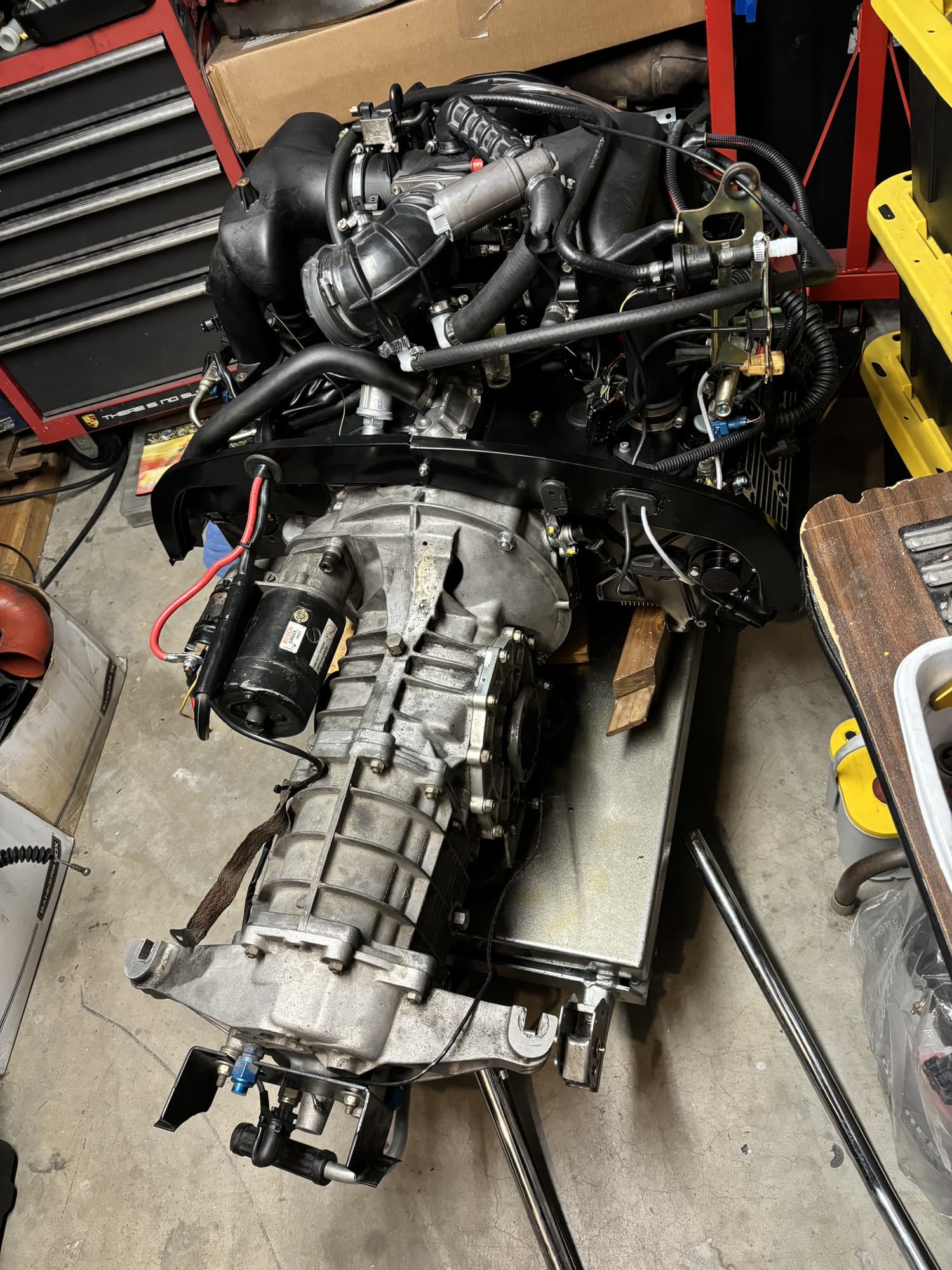

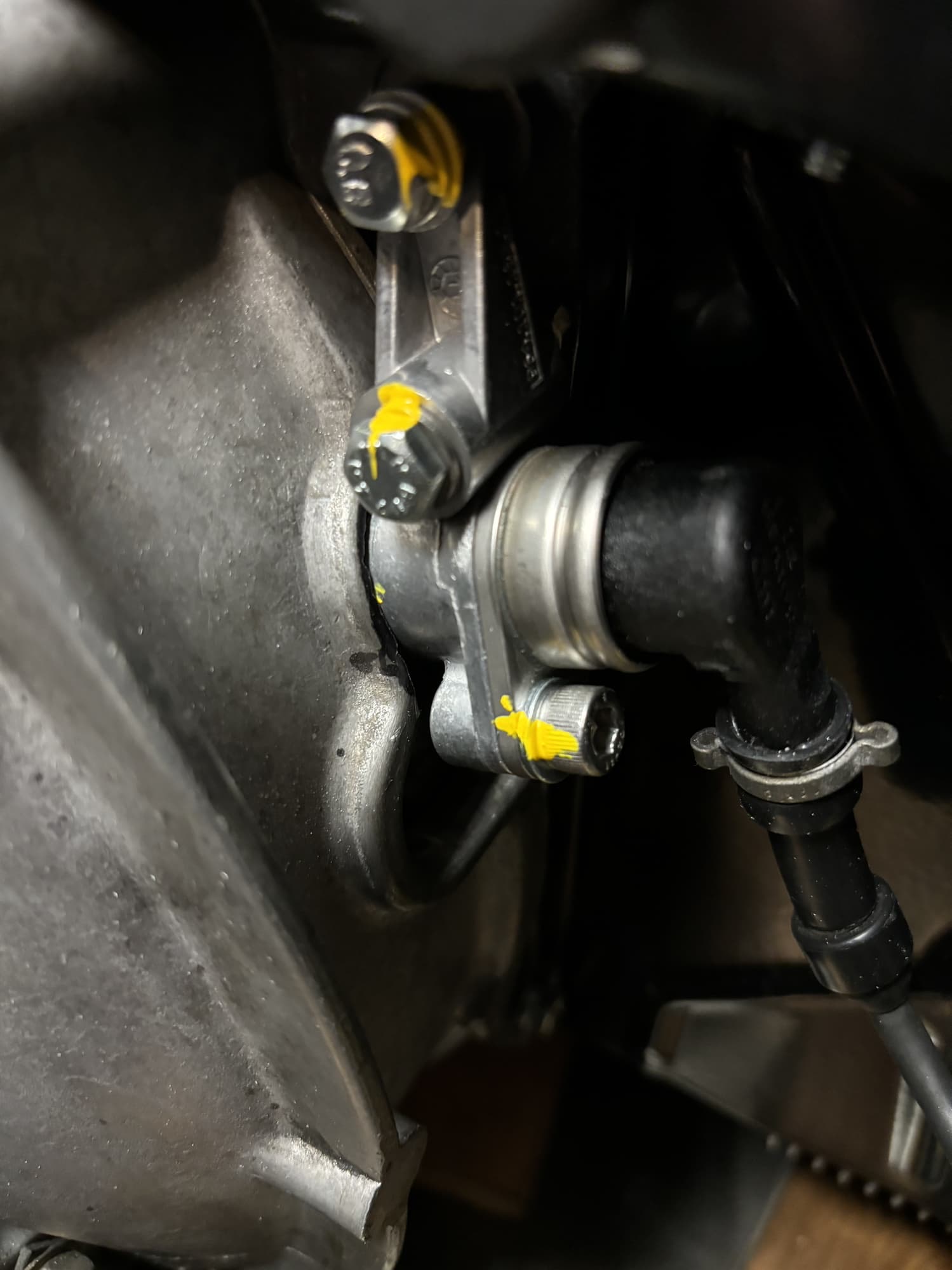

I had to separate the 915 trans to make the 3.2 sensor hole bigger. I removed quite a bit and you can see it’s still a tight fit. I also drilled out the bottom hole of the sensor hole with a 1/4” drill bit to get the flywheel clearance closer to .8mm. The Martin Bott kit also has a different backup light switch, so had to swap that out. The starter wire is also a spade connector. On another note, verify your gauges match the 3.6 senders or you will need to change the gauge senders. I verified my 3.2 gauges use the same senders as the 3.6, so I am good to go. See picture below of my combo gauge.. ah well. all done and ready to go in the car this weekend.

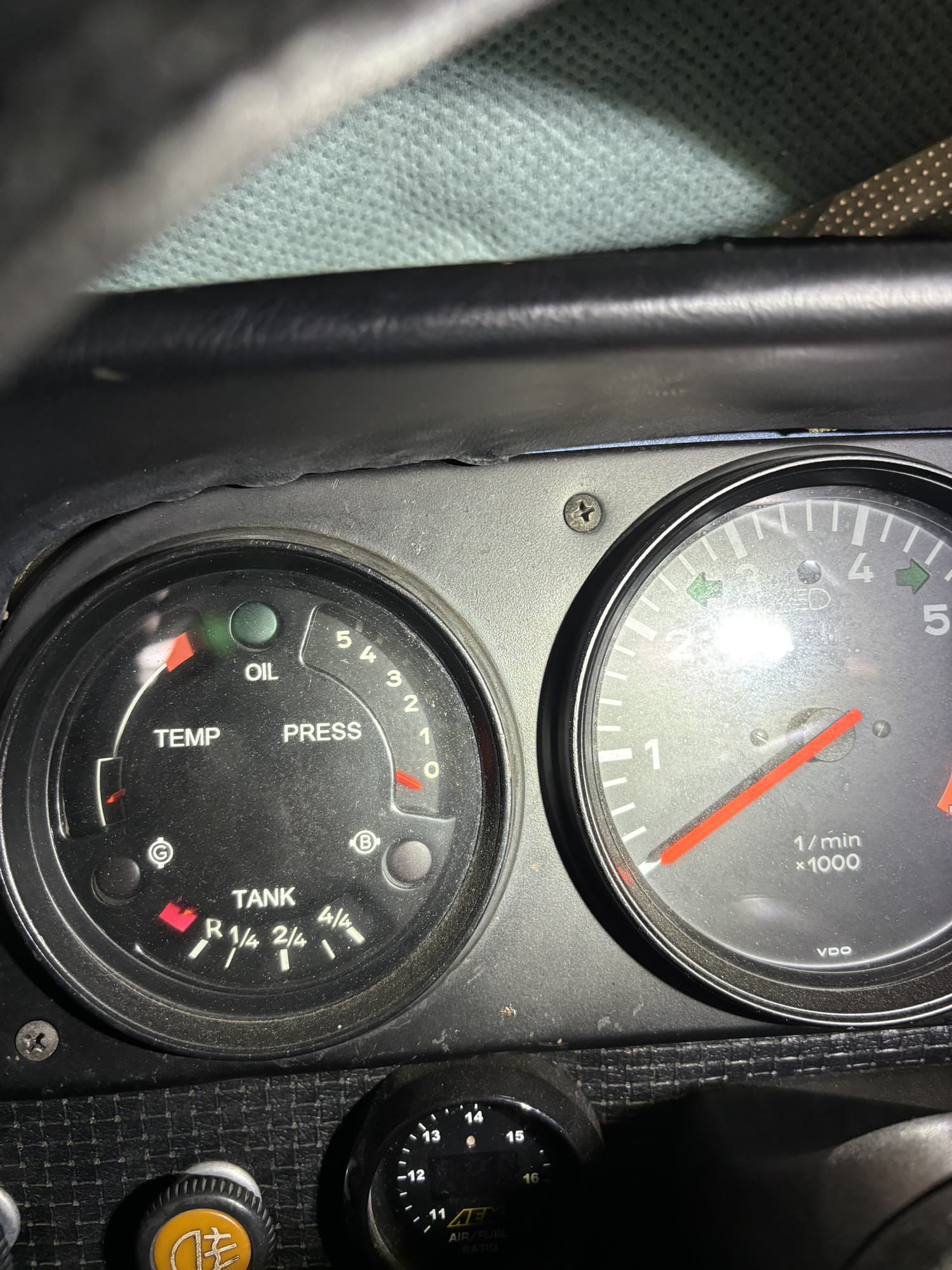

Steve   Still won't start, but I am learning a lot abo...   Oct 28 2024, 09:14 AM
