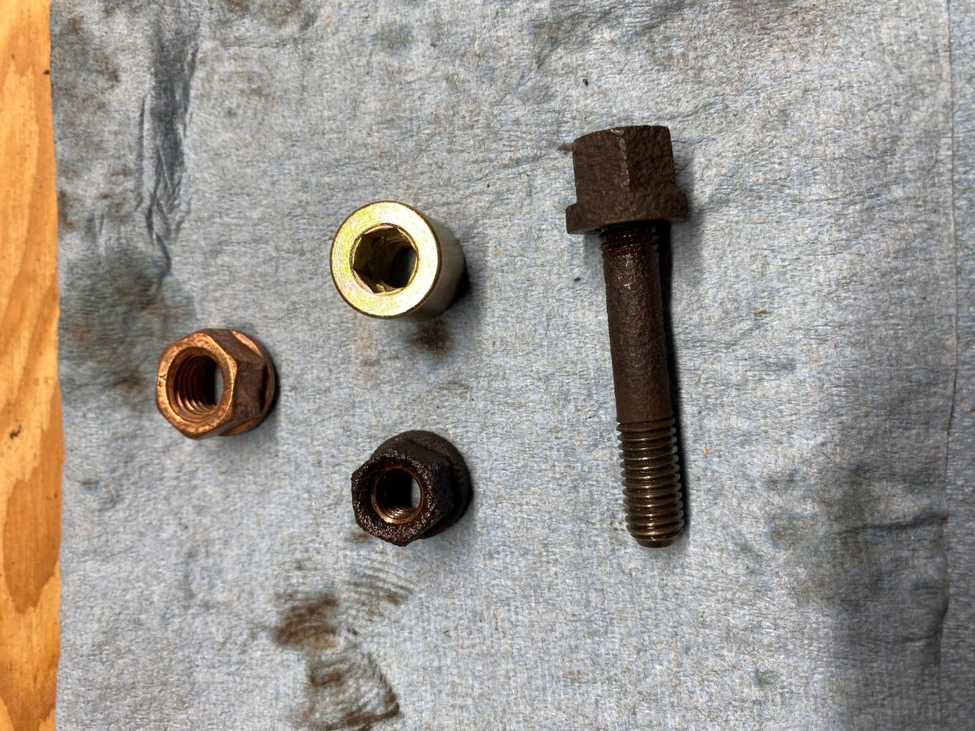

Generous amounts of PB Blaster were applied to the fasteners for several days before pulling this apart. Luckily no exhaust studs snapped - however in 3 locations the studs came out instead of the nuts coming loose.
You can see the condition of the threads in the picture. Also shown are the new nuts I purchased (although the copper lock nuts are the wrong thread size). I have not tried to remove the old nut from the stud now that the stud is out of the car - perhaps best to get new studs for these 3 locations. I also plan to use some anti-sieze for the re-install.
