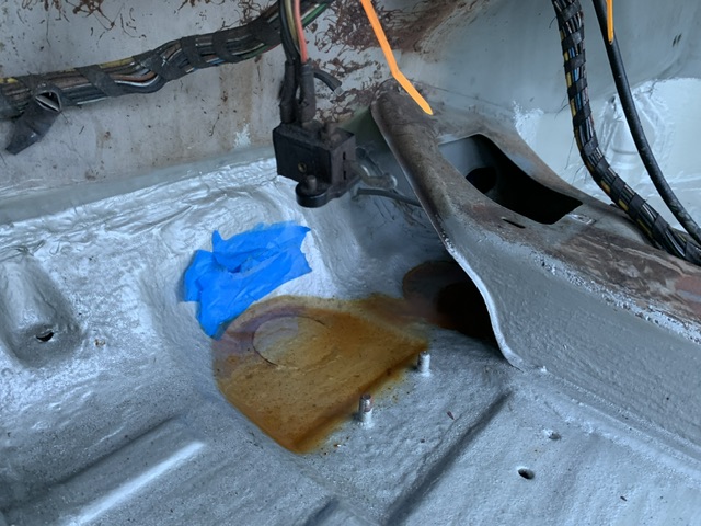

Need a waterproof car cover. Thought this was fine but apparently not.
Shows my floors are fixed well enough to retain water. Far cry from what I started with so there is that.
